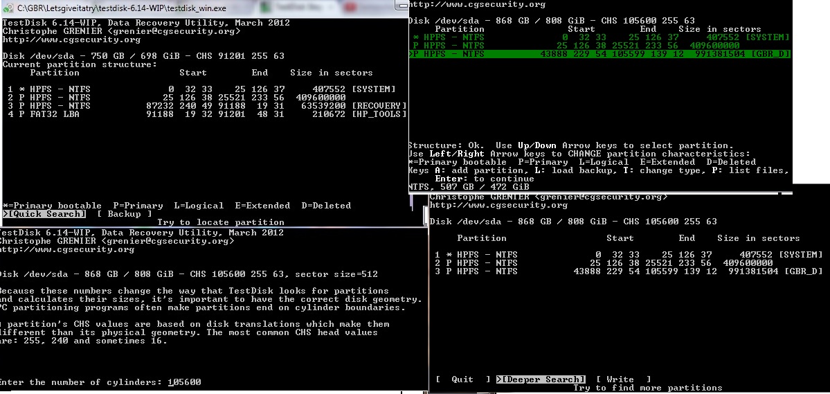

#1 Post by GBR422777 » 27 Mar 2012, 13:52
how can i solve this....?i deleted my partition's MBR by mistake
please help!!! can i recover? or can i even recover the data?
the first one is the partition lost...the rest are of the other system partition which i recover using a windows boot cd..
thanks a lot:D
what should i do.jpg (254.9 KiB) Viewed 7633 times

Re: MBR deleted from a logical partion using test disk..
#2 Post by Fiona » 27 Mar 2012, 14:58
TestDisk doesn't delete any MBR, but a partition table would be possible using the menu delete.
But in this case, testdisk will find partitions using the boot sector.
On your first screen, that partition starts in the middle of the disk and ends after disklimit.
Also, that partition starts far away from your second partition.
At least it has a label.
Before I suggest anything tricky for diagnosis purposes, I'll see your results of the Deeper Search.

#3 Post by GBR422777 » 27 Mar 2012, 15:28
thx a lot fiona, but i'm afraid this was the result of deeper search..so should i change the disk geometry? and how ...any advice...and yes i cleared the bits of mbr using the main menu...clear MBR sets all bits to 0..so is it possible to recover? thanks again..a loooooooooooot:D

#4 Post by Fiona » 27 Mar 2012, 16:34
Please let me know, how did you do that?
Are you sure, that you confirmed with enter at this screen?;
http://www.cgsecurity.org/wiki/File:Search_menu.gif
Because Deeper Search searches additional for partitions using the backup of the boot sector.
So it often finds more, but it takes a little bit longer.
Only using the menu MBR code or Delete wouldn't move any partition including a boot sector somewhere in the middle of nowhere, like your partition is listed on your first screen;
This partition ends 200 GB beyond your disk limit
Normally it changes only the MBR or partition table.
The size of the MBR is only 1sector of 512 Bytes.
That's why it's difficult to judge.
Please, try the following;
Confirm in TestDisk through until you see Analyse.
Don't confirm at Analyse but Geometry.
Please check Cylinder.
Change the value to 105600 .
Leave the menu at OK
Check Analyse and press enter.
Proceed at Quick Search with enter also.
If TestDisk starts a scan, wait until you see that partition GBR_D.
Press enter to stop the scan.
Your partition with label GBR_D should be listed.
Please upload a screen.
Check that partition and press p to list your files.
But it'd only possible as long as a boot sector is recognized
Do you see your files or an error message.
This is only intended for diagnosing purposes.
It doesn't change anything to your HDD.
Don't use write or anything else!
Pleas let me know.
If not, it might be an idea to add a partition on your unallocated space manually to have a boot sector diagnose.
Should be exactly the space of your previous partition.

#5 Post by GBR422777 » 27 Mar 2012, 21:42
i recover the system partitions (windows 7) using a windows 7 format cd, booted then i chose repair instead of install..then clicked on start up repair..and that's it!
btw i did what u told me abt the cylinder and i thk it worked:D
i see my files yeeeeeeeeeeey hehe:D
i press enter to continue, now what should i do ? i dn't want to do anythg wrong!?
P.S: earlier 2day (b4 this search..) i did write MBR Code on the disk..and it said it will take effects after restart but i never restarted!
so i'm afraid if i did somethg wrong..is it ok? or should i do smthg abt it
I'm attaching the procedure u asked me to do..
thanks again:D
is this the right way.jpg (227.32 KiB) Viewed 7616 times

#6 Post by Fiona » 28 Mar 2012, 08:19
As long as you don't write anything you're not going to change anything to your HDD.
That's important.
This procedure is only intended to copy your data to another intact drive/partition.
If you list your data, at the bottom of the screen you can find all necessary commands.
Standard destination to copy files is your testdisk folder.
You also can create another one to copy your files to.
Check an created folder and using the right arrow key, will open that folder.
Checking those two dots and pressing enter changes directories.
Please backup/copy your important data.
If you're finished, easily close TestDisk.
Nothing will be changed! :)
