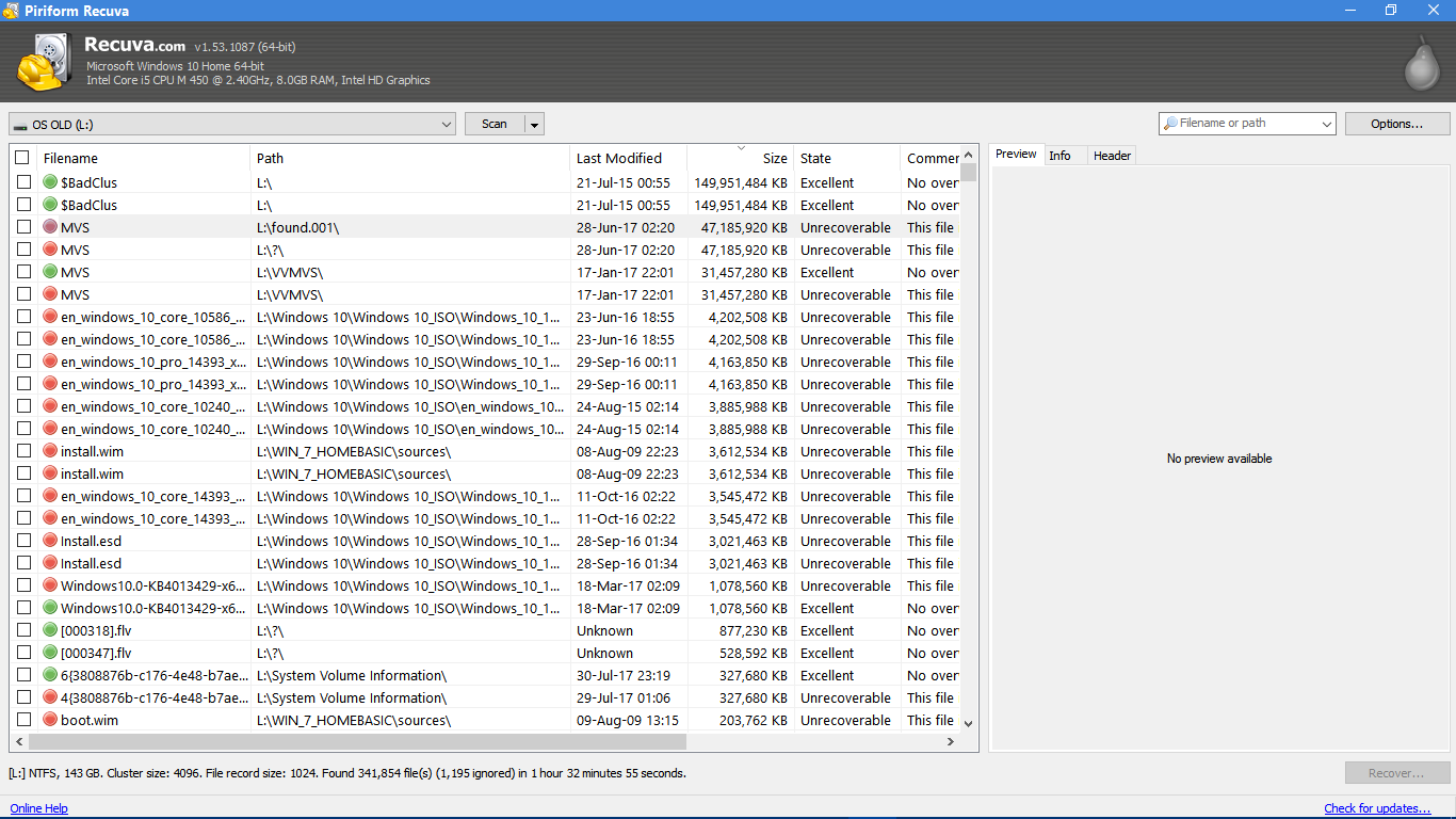

I've attached a screenshot of the Recuva recovery list. The file named named MVS (marked excellent) is what I'm trying to recover and one named found.001 is the latest possibly corrupt file ( I do have a back up of this).

Tried the filter but the 'MVS' file is not listed although it shows up in Recuva. Is there a deep scan option like the one you have in the 'Analyze ' option. Or, does TestDisk not recover encrypted files for some reason?

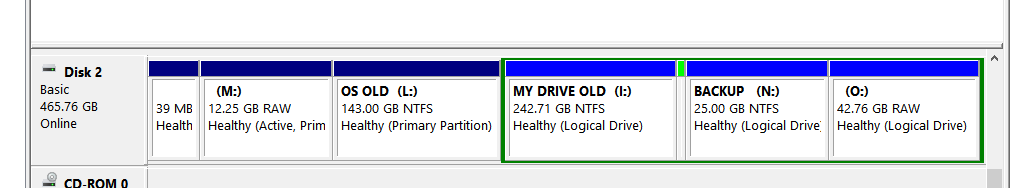

Just a brief background of the problem above. The concerned external hard disk is my old laptop disk which I use for secondary backup and connected via an enclosure. The disk was partitioned as follows:
![Image]()
The corrupt Vercrypt volume (MVS - 45 GB) happens to reside in drive L:
On the fateful
day, I had connected a USB flash drive to a port adjacent to the external one. Since the flash drive was showing unusually erratic behavior--likely caused by the slightly problematic external disk-- I disconnected the external disk via 'safe-removal'. Now, the flash drive was back to functioning normally and I could continue as normal.

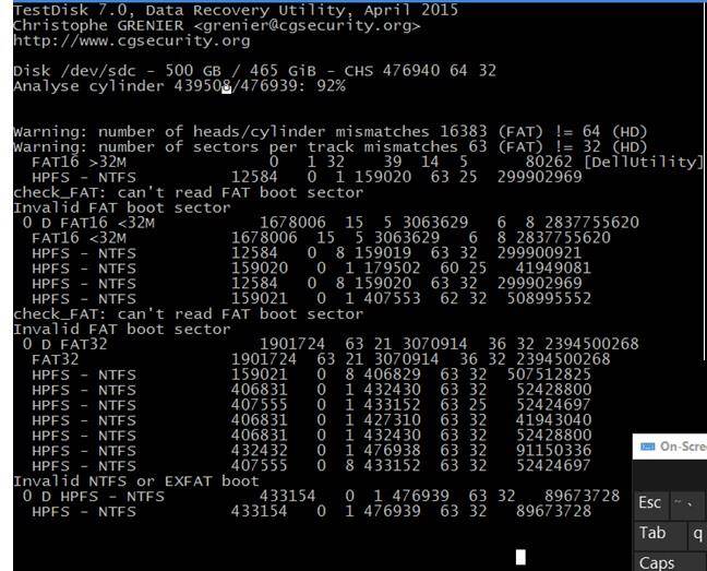

Then, upon connecting the external disk back I was shocked to find (in Disk Management) unallocated space (28X GB) where there used to be two Dcrypt partitions ( 242 GB + 4X GB). The partitions to the left were intact. Since I already had the backup of the two wiped out partitions, I went ahead with a quick format of the unallocated space in the hope of recreating the said partitions. Upon completion I was asked to restart which I did with no anticipation of what was to come. After the restart there was more pain in that now drive N: too was gone along with the veracrypt container in L:. In its place was a file named file00000001.chk (45 GB).

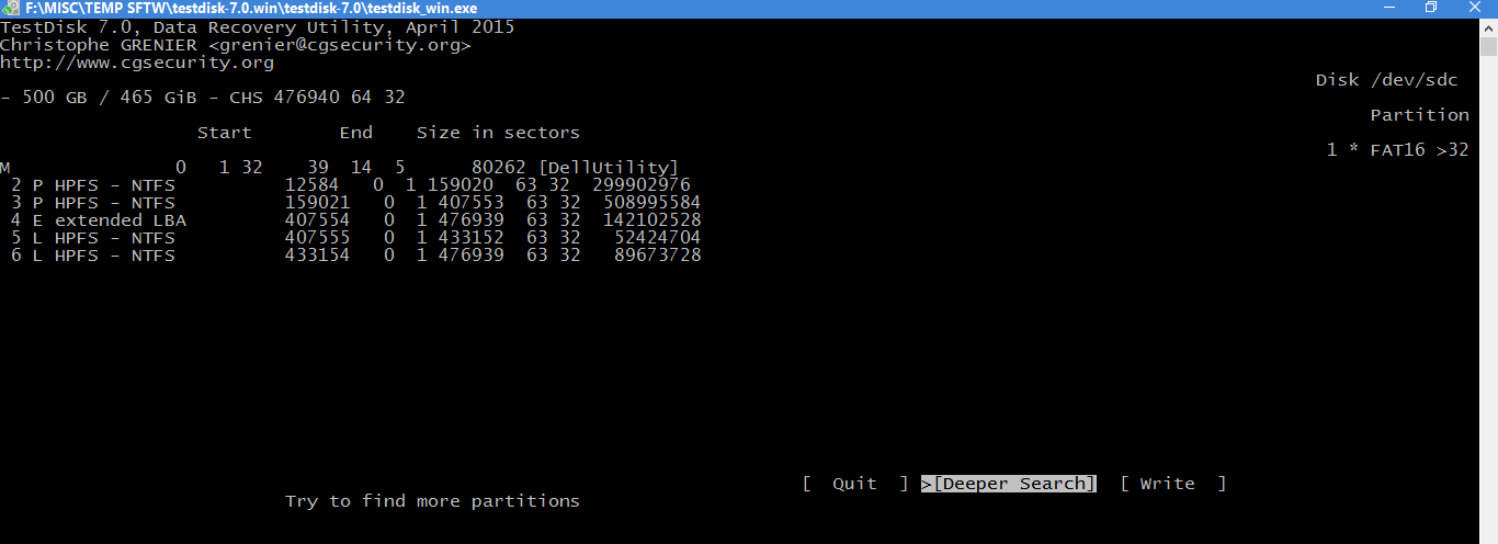

Subsequently, I tried fixing the chk file with the Unchk3 tool and the built-in chkdsk command to no avail. I also ran the extended (nearly 20 hours) search on the concerned drives i.e. the whole disk, drive L: and the mounted veracrypt file (drive S:) using TestDisk. Although I couldn't make much sense of the results, TestDisk reports the encrypted partition as 'structre is ok' but can't list the files it contains.
I'm posting screenshots of the same. Hope someone can have a look and advise me on the next action.

![Image]()

Not enough space to ttach one file above. So, it's here
![Image]()
- Whole disk_before deep search.png (26.75 KiB) Viewed 18694 times
