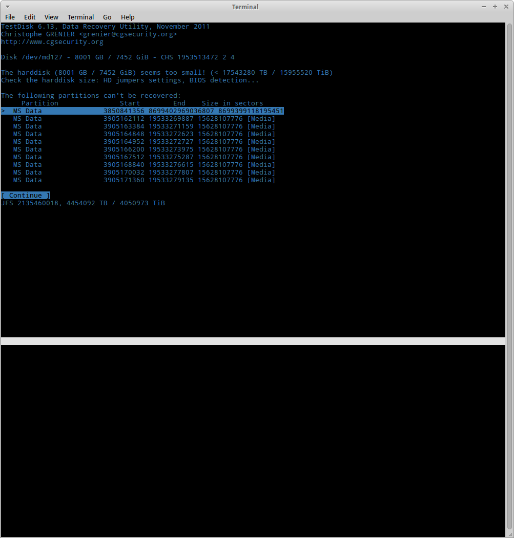

Essentially I messed up when I was tired and formatted my md array with an MBR partition table when it was previously using GPT (I was meaning to format a usb flash drive). This wiped out the partition table, and the existing partition (just one was on the array, "Media"). Since then I've been looking into ways that I might recover some or all of the data. I came upon your TestDisk tool and have been playing around with it.
I have NOT made any other changes, the only thing that has been written to the disk is the MBR format (it has never been mounted as there are no partitions currently on the MBR table and I have not made any changes using TestDisk as i want to be 100% certain before making any changes). So, I have a bit of optimism that my mistake may be able to be corrected.

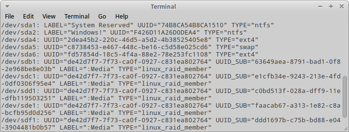

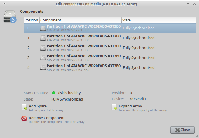

Let me also make clear that the raid array reports itself synchronized and no disks have failed. The partition table on the array itself has been wiped, nothing on the individual disks has been changed directly.

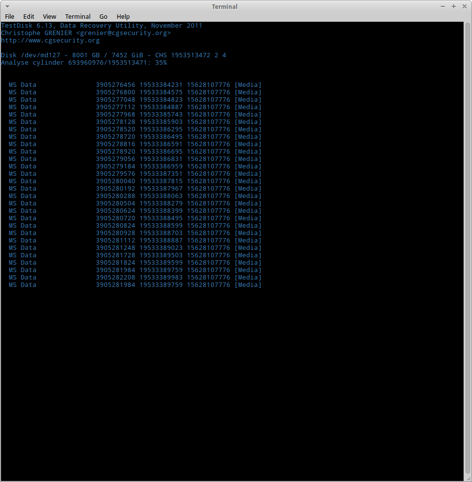

Right now TestDisk is running a Deeper Scan (about 35% complete) as the Quick Scan doesn't find anything within the first thirty minutes or so. The Deeper Scan finds my Media partition almost immediately (I'm running the scan on the md array itself). If I allow it to run the Deeper Scan continues to find additional Media partitions (I'm not sure why on this?). The first two numbers are all slightly different, where as the end numbers are all exactly the same.
For example, the first one goes as such:
MS Data 3905276456 19533384231 15628107776 [Media]
The current last one goes as such (see screen shot for more):
MS Data 3905281984 19533389759 15628107776 [Media]
There are five drives in the array all of the same make and model and the file system was ext4. However, if I stop the scan it doesn't show me any partitions to browse through and list their contents. I can add a partition, but when I select GPT (your equivalent) and then EXT4, it doesn't allow me to list the contents stating that it's damaged or broken (I can't recall which right now). However, if I say the file system is the md array 1.x one it doesn't allow me to list the contents but there are also no indications that anything is wrong. I imagine this is just because the program can't read it without a file system but I'm just trying to give as much information as possible.

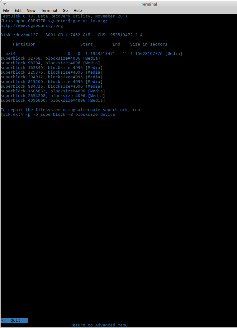

Usually /dev/mdX device are not partionned themself. If you select /dev/md127, Partition Type: None, Advanced, Type ext4, Superblock. Does it find something ?
Micheal
Joined: 28 Feb 2012, 16:33
Re: Mdadm RAID 5 Partition Recovery
#3 Post by Micheal »
Sure enough it does. Attached the results along with the results of the Deeper Search when I stopped it at some point past 60% just in case they are of any additional help. (Some were too big to upload).
