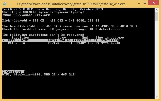

Re: The harddisk seems too small!
I have a problem that looks similar.
I connected a new disk (SSD, 128 GB), and when looking at the list of devices, I noticed drive H: of which, when clicked, the system (Win 8.1) said that it had to be formatted in order to be used, so I did a quick format. At that point, I realized that my external 500 GB backup disk was not listed among the drives. It used to be listed with a red bar, because it is almost full (The other disks I have in the system have a green bar, and indicate they're about half-full.
Turns out that somehow, the system mixed up the 500 GB drive and the new 128 GB SSD, and formatted the 500 GB drive, which now has a 127 GB partition on it...
TestDisk indicates that the drive seems to small (which isn't the case) but the numbers are not correct, so I guess what's happened with this disk (quick format on only part of the disk, I guess) leads to wrong conclusions. I wonder if there's a way TestDisk can be helpful to recover the data. Could it be that to restore the data on this disk, first the incorrect quick format should be undone (to set/get the original size of the disk correctly), and that only then the original index could be recreated?
In addition, I think the disk was formatted using FAT-32 (it is quite old Could it also be that the quick format (NTFS) has partly overwritten the

- TestDisk.JPG (54.17 KiB) Viewed 3724 times
- DiskManagement.JPG (150.71 KiB) Viewed 3724 times
Please go on next screen to see the results that TestDisk considers correct. A valid 500 Gb NTFS partition should be listed.
