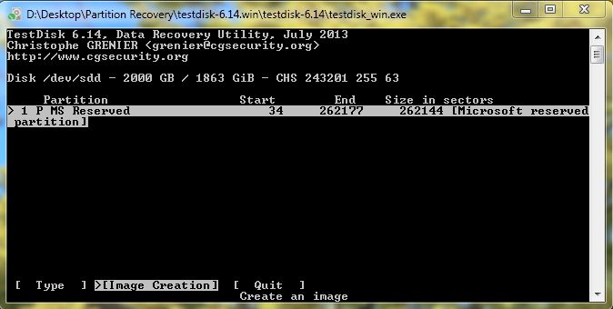

I have gone to option Advanced, and there is only this screen;
There are further options for Type or Image Creation or Quit, but no Boot option. Is this the screen you wish to see?

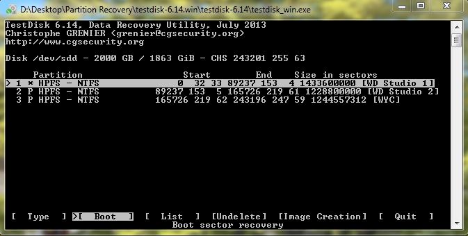

This time I was able to reach the Advanced / Boot page;
Advanced
Advanced
Advanced pre Boot.JPG (46.54 KiB) Viewed 7904 times

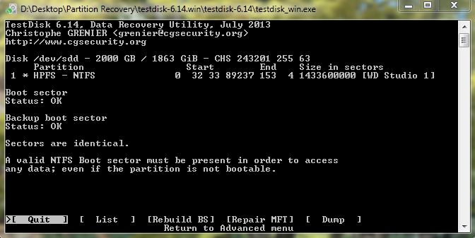

Thereafter the Boot page;
Boot
Boot
Advanced Boot.JPG (46.78 KiB) Viewed 7904 times
The Boot Sector and Backup are identical. Should I Rebuild BS?
