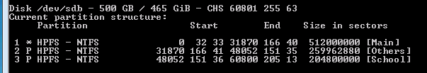

You mean this?
When i clicked quick search it shows this.
Re: Partition drive is not accessible!!
Posted: 05 May 2012, 17:53
At least your partition table looks ok.
Do you have no access to all three partitions?
At your second screen, where your partition are listed green, if you check a partition and press p, do you see your data or an error message?
I don't see any faulty boot sector either, because if a boot sector would be faulty, TestDisk wouldn't list that partition after Quick Search.
Please let me know did you see your data and another screen from your disk management console would be appreciated also!

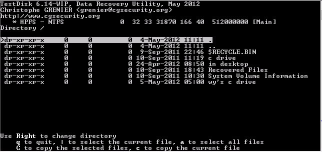

Only 1 partition is faulty. I only do not have access to 'others' but can access inside my 'main' and 'school'
'Main' is J: drive, 'others' is K: drive and school is L: drive.
what do you mean green list?
this is what happens when i press p

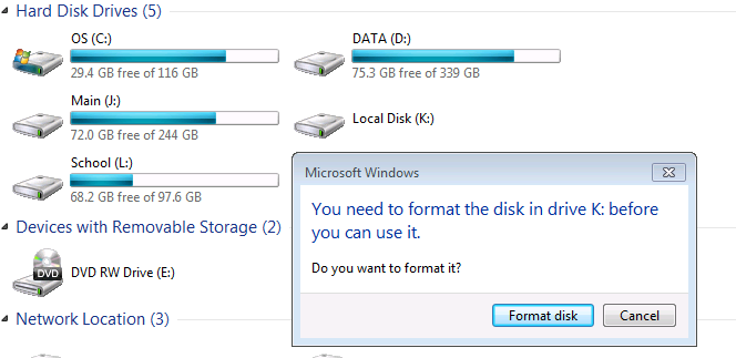

this is what happens when i clicked onto 'others'/K: drive actually it can't be accessed. but i do not know why it ask for formatting. :X

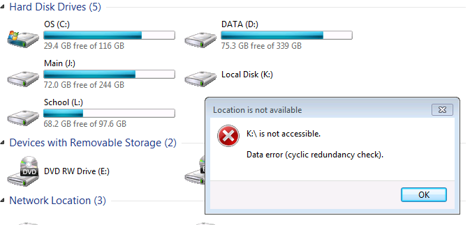

It loaded for awhile more and this error message showed

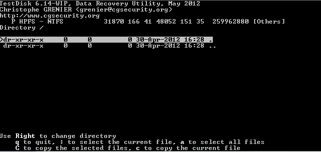

This is what i get when i go press p in 'others' K: drive. I can't see my info in the drive. But other drives can see.

Unfortunately it looks like that your file system from your K:-drive (others) is damaged.
CRC-error (Cyclic Redundancy Check) means that the checksum is not valid and indicates a damaged file system.
Windows doesn't display the label "others" but only local disk.
A safe solution would be datarecovery software.
But you can teste to have a rebuild of your boot sector as a diagnose.
As long as you don't confirm at Write as long you're not going to change anything.
It's only intended to have another try to list your data and copy them to another intact disk or partition.

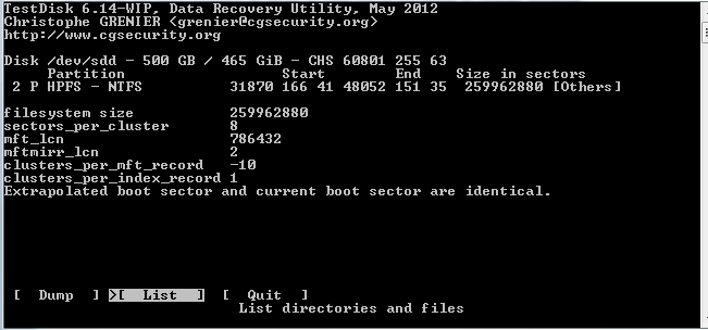

Posted: 06 May 2012, 08:54
by unknownmaster80
Hi, You said to Rebuild BS. but after that this page shows up. so am i suppose to list or dump it?
