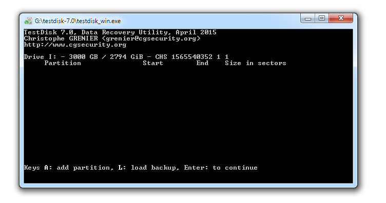

I've uploaded a screenshot of Testdisk.
There are lots of read errors. Testdisk is generating a read errors each time it analyses a sector.
Thanks for your help.

The process has completed. Here is the screenshot showing options at the bottom.
Testdisk created a 3.4 TB text file from scanning a 3 TB hard drive.
Any advice? Should I select one of the options?
Much appreciated.

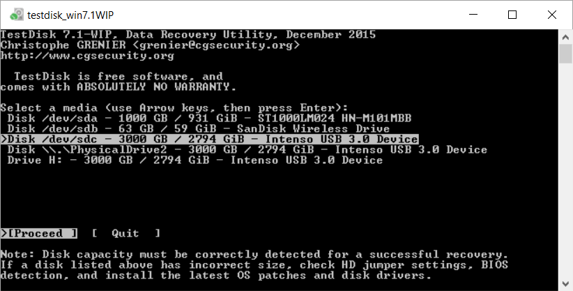

A drive is like a partition and a partition can't contain a partition.
Under TestDisk disk selection, can you select your disk instead of a drive?
Only a disk has a partition table.
So I'd be able to judge your current partition structure (partition table) after confirming at Analyse.

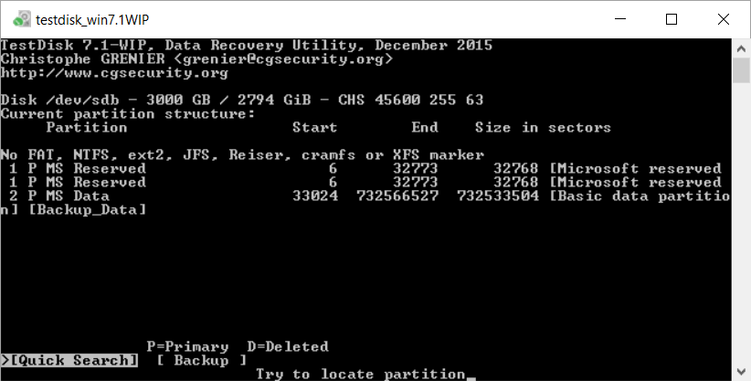

When your drive would be correct, it' would be possible to run a boot sector diagnose?
But I can't judge it, because I've no info about your partition table.
That's why I've suggested to select your Disk and confirm through until you see Analyse and your current partition structure (your current partition table).
I've uploaded an example!
And the current partition structure (table) of my disk:
When you're sure that your drive is correct, you can run TestDisk / Advanced / Boot to check the status of your boot sector and have a try to list your data.
In case you can upload another snapshot.
Your current snapshot didn't display any file system?
