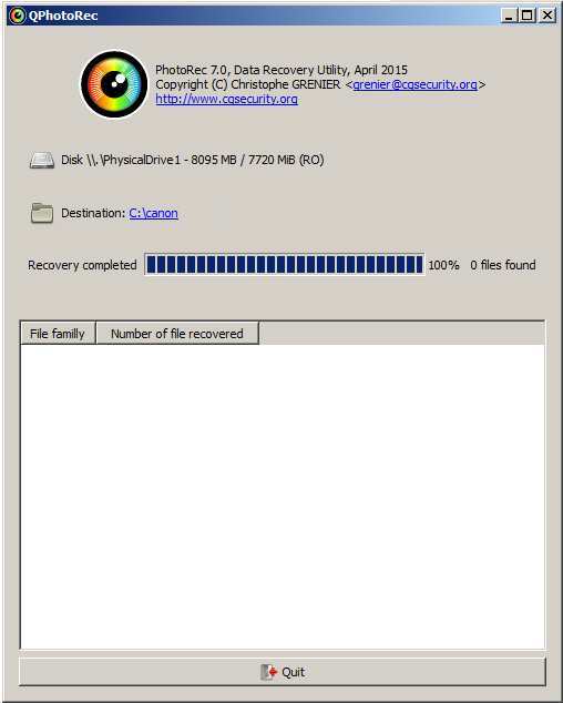

Thank you for the response. These are the images of the boot sector. Can you assess what is going on based on these results? I can see the boot sector and backup are not identical. If I edited it somehow, would that fix the problem? The results of PhotoRec were unsuccessful.
photorec results.jpg (24.9 KiB) Viewed 4390 times

I tried Stellar Phoenix without success. I tried another recovery program and it only recovered gibberish text files and one large 7.5GB MPEG file. I know for certain I didn't have any MPEG files on the card. I have used a hex editor to see if anything is visible in any data sectors. I see a bunch of letters and numbers. I can't format the card even if I wanted to. Maybe there is damage to the controller. :(
