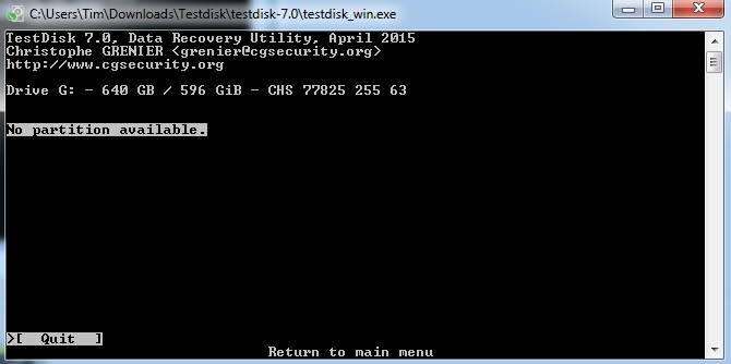

Re: recovering files on my external drive
When I choose advanced, I get this:
- testdisk2.jpg (39.2 KiB) Viewed 6520 times

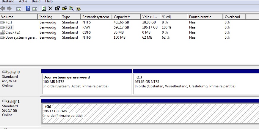

in diskmanagement the drive shows up
- diskmanagement.jpg (125.41 KiB) Viewed 6506 times
Select PhysicalDrive1, not G:

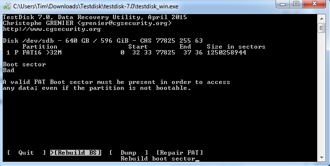

my mistake. When I do that and boot, I get this:
- testdisk4.jpg (61.13 KiB) Viewed 6459 times
do I have to repair FAT?
In Advanced, choose type to force the partition to FAT32 LBA, Boot, RebuildBS, List. If you can see your files, choose Write, confirm Quit.
If your partition was exFAT or NTFS, choose the partition type 7 instead.

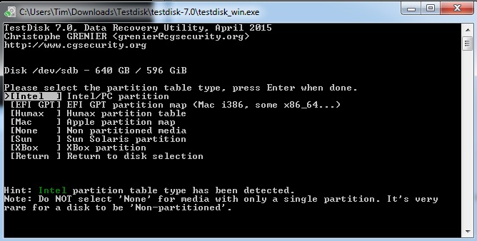

which partition table type is for FAT32
and in case its NFTS, option 7 is xbox??
- partitie.jpg (75.87 KiB) Viewed 6439 times
