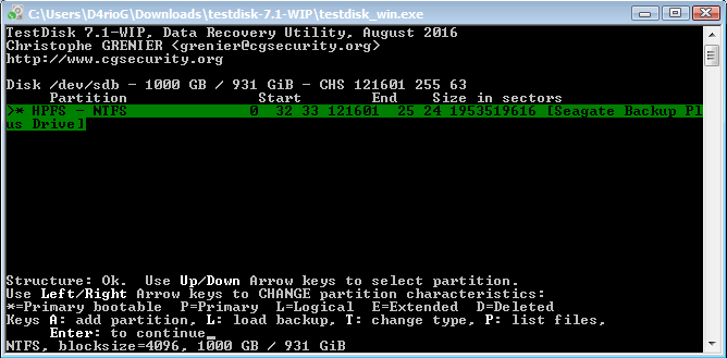

I am dealing with a 1TB external HD which appears in disk management as follows:
Basically, I followed the TestDisk Step by Step guide, and I managed to get to this stage:
in fact, I can list all files pressing P, but when I try to write the new partition structure I click [ write ], quit the program, reboot my laptop with the usb HD connected but nothing change. After reboot, the HD appears as connected via USB, still not visible in the explorer, and still unallocated in disk management.
Am I doing something wrong or is there a way to figure out what's going on?
(I thought that since I am able to list all files I should be able to recover the partition)
cheers,
D
Re: Unable to recover partition
Posted: 10 Apr 2017, 06:28
Maybe another process is preventing the write operation to be completed. Boot your Windows in safe mode, try to disable your antivirus and try again to recover your partition.
Posted: 10 Apr 2017, 13:38
by d4riog
cgrenier wrote: 10 Apr 2017, 06:28 Maybe another process is preventing the write operation to be completed. Boot your Windows in safe mode, try to disable your antivirus and try again to recover your partition.
Thank you, I tried to recover the partition in safe mode but nothing changes. After clicking on [ write ], I quit and rebooted as suggested but no change as well.
If I reload testdisk I still get "Partition: read error", I click on [ quick search ] the partition is detected, I click enter to write the partition table and asked to reboot again.
In an ideal scenario, after rebooting the HD should be visible in the explorer, right?
I just wonder what else should I try to understand why the write operation is not performed. Any suggestion? would posting a log file help? I am lost.
Posted: 13 Apr 2017, 22:51
by d4riog
By the way, the following is the testdisk log file.
In the meantime I figured out that when I list files I am actually able to copy them (at least the copy of small files did not failed but I haven't tried with big ones).
What's the best strategy at this point? Would using ddrescue take ages due to the size of the HD (1tb) and the speed of my computer/laptop?
thanks
