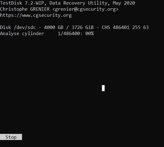

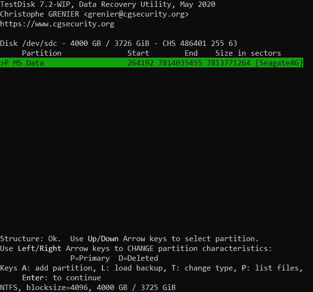

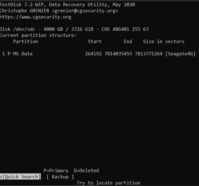

TestDisk under Windows finds the drive, finds the partition, seems to restore it, but after a reboot Windows still won't recognize it, as if nothing happened.

I did not take screenshots in Linux, nor in Windows. I cannot go back in time and take screenshots under Linux. I added the first 3 screenshots to my first post and the last 2 to this one.Post screenshots of what you did in Testdisk and attach them directly to your posting here using the attachment tab on the bottom of the page so that all your information is here and readable for others in the future.

Testdisk states in a picture above that the structure is OK.
With your unstable USB connector the obvious solution is to duplicate your drive under Linux either on file level or as a whole to another drive without any physical connection problems.
