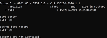

I am having a small problem with my exFAT partition (using Windows 10). After a BSOD, the exFAT boot sector and its backup sector are no longer identical:

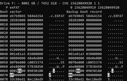

However, they are both being listed as "OK". Looking at the dump, it is also not immediately clear which one I should overwrite with the other (the highlighted small differences are the only ones, even when scrolling through the rest of the dumps):

Thank you. I used HxD to compare the boot sector and backup boot sector of the affected drive with a cleanly formatted exFAT drive and determined that the region in question should look more like the backup sector, so I used that to replace the main sector. Unfortunately, this did not fix the chkdsk error mentioned above. Still, would have been nice to be able to store and restore the boot sectors with testdisk before taking any action. I also tried rebuilding the boot sector, without an effect on chkdsk.
