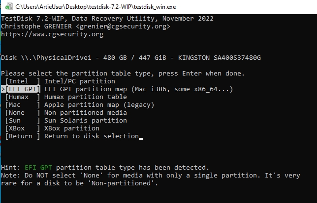

So, back to Testdisk...When I select the drive and then need to select the partition table type, there is a note
Hint: EFI GPT partition table type has been detected. So I guess there are still GPT entries.

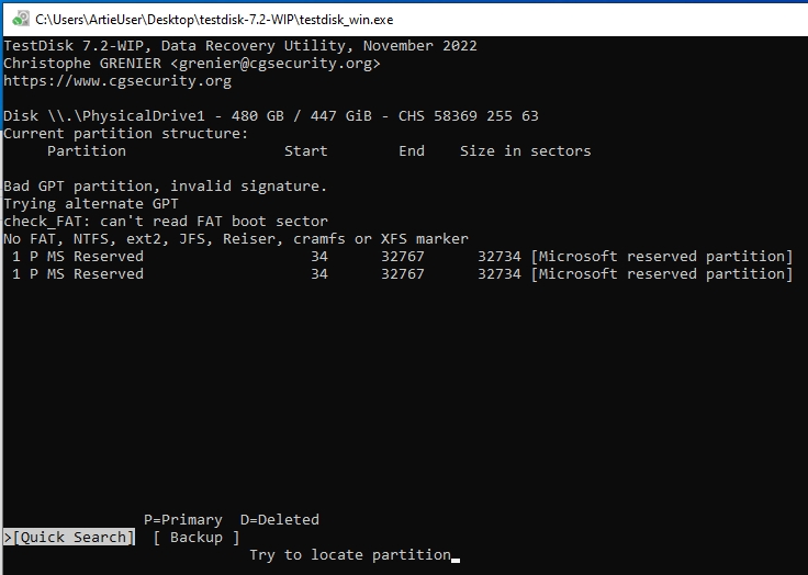

If I select EFI GPT and Analyse, it says Bad GPT partition, invalid signature. Below it shows two identical partition entries:
1 P MS Reserved 34 32767 32734 [Microsoft reserved partition]

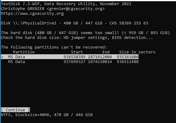

If I then select Quick Search, the message is "The hard disk 9480 GB / 447 GiB) seems too small!" and lists 2 MS Data
partitions that can't be recovered. So I hit Enter to continue.

OK, attached first 3 screen shots of using the EFI GPT partition table type selection.
- drive_selected.jpg (126.38 KiB) Viewed 29887 times
- drive_selected_menu.jpg (85.35 KiB) Viewed 29887 times
- efi_gpt_analyse.jpg (116.6 KiB) Viewed 29887 times

One more screen cap and log file to this point.
- efi_gpt_quick_search.jpg (102.18 KiB) Viewed 29886 times
