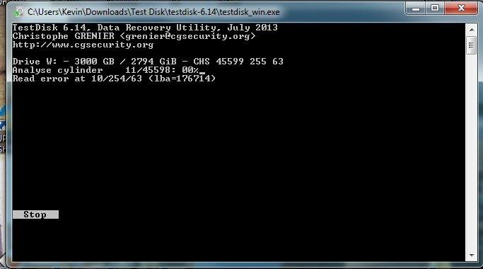

I have tried TestDisk, but either get read errors for 24 hours after which time I stopped the test, or the program reports that it cannot see the partitions. I seem unable to save a log file.
I have tried Recuva, Gparted, and have had no luck in seeing the drive.
I hope the screen shots help in a diagnosis, and wonder if you can help me get my drive back?
I tried an analysis with Test Disk. I ran past 108% and reported read errors all the time. After 24 hours I stopped so that I could try other options.
9 Read errors all the time.jpg (30.42 KiB) Viewed 2727 times

The disk is probably physically damaged. Try to clone it to a new disk as described in
