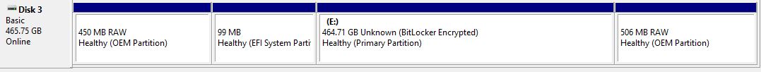

I re-read your post and noticed you said to decrypt the drive first. this was my mistake, I only "unlocked" it.
when I try to decrypt the drive, I get this message::::
C:\WINDOWS\system32>manage-bde -off e:
BitLocker Drive Encryption: Configuration Tool version 10.0.18362
Copyright (C) 2013 Microsoft Corporation. All rights reserved.
ERROR: An error occurred (code 0x80070015):
The device is not ready.
please help!!!

when I try bde repair, I get this error::::
C:\WINDOWS\system32>repair-bde.exe E: M: -rp 009482-xxxxxxxxxxxxxxxx -Force
BitLocker Drive Encryption: Repair Tool version 10.0.18362
LOG ERROR: 0xc0000030
Failed to open 'E:'. (0x80070020)
ERROR: Cannot open 'E:'. Check that it is not currently in use. To continue
even when the volume is in use, add the -Force option.

Use the powershell command "manage-bde -status".
Use the logfile option of bde-repair.exe. Maybe you get more detailed information.
Anyway, Microsoft will be happily answering your question. ;)
Use the -keypackage parameter if you had generated one.

I was able to run the bde repair
1st I saved it to a .img file, but wasn't able to open it w 7zip... it got to a 100% and just hung there (with one error)
I tried again and I repaired the disk to another disk (source 500 gb, destination 2 tb)
I ran BS repair and it crashes on me, please see logs:::

iepso
Posts: 17
Joined: 08 Aug 2019, 23:02
Re: bitlocker boot disk crashed-- cant repair file system
#10 Post by iepso »
Thank you
I managed to use "repair-bde.exe".
I first tried to a spare hdd I have, it's 2TB. When I tried accessing the partition, I received messages saying there is no file system.
next I "repaired" it to an image. I could not browse it using 7zip.
I did manage to recover some files....
I mounted the image with "Gizmo" then formatted it, then used "Recuva".
the problem is that most txt files were corrupted with garbled, indistinguishable characters. a lot of duplicate files too.
while mounted with Gizmo. I see the drive in TestDisk (drive Z). I tried finding partitions but did not have luck.
now that I am able to "Repair" this bitlocker volume, is there some guidelines on how to attempt recovering this file system?
please see log file below.
thank you!!!!
