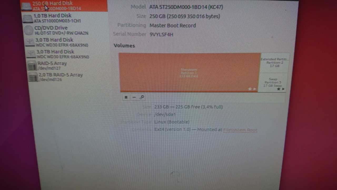

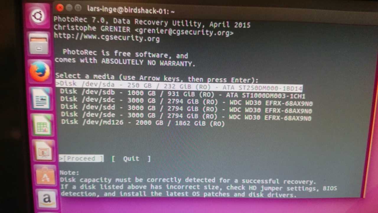

However, the disks are not showing up as they did before. Previously I had a logical volume with the correct size (from the NAS). Now I have them listed as the picture below shows. SDB, SDC, SDE and MD126 are the drives that was installed in the NAS.
Since I'm not an expert, it is possible to just run photorec on each individual disk?
