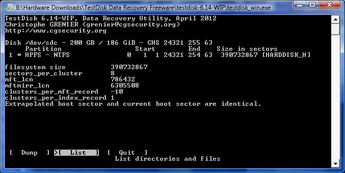

I've tried rebuilding the boot sector and now I'm getting conflicting results. Before the rebuild, the sectors are not identical, but afterward, TestDisk says they are. Yet when I run it again, they are not identical. Here is my log file:
I've attached screenshots of before and after the rebuild. I would attach a third image showing what happens when I re-run the software, but it is the same as the "Advanced_Boot.jpg" image.

Sectors are not identical.

Status: OK
ntfs_boot_sector: Can't read backup boot sector.
Status: Bad

Status: OK
Status: Bad

Status: OK
Status: Bad
