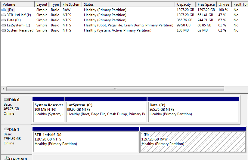

I'm having an issue. I have a 3TB Seagate HD partitioned in half (2 partitions approx. 1.3TB each) and formatted NTFS using GPT. It's been working fine for over a year until a couple of weeks ago. I had the drive connected to an older Win2003 server that recognized the physical drive as two drives and loaded a bunch of files onto one of the partitions. I went away for a while, leaving the computer running and drives connected, idle - everything seemed fine. Upon returning however a few days later, I found the computer had rebooted due to a power problem and my UPS did it's job correctly. But, there is now a big problem with my 3TB Hard Drive - it only shows one of the partitions as normal; but the other partition in the Disk Manager shows up as RAW and Windows asks me to format it. Thinking somehow the MFT got corrupt (not thinking it's partitioned as GPT), I ran CHKDSK - only to have it run for a few days before I killed the process. So, I decided to give TestDisk a whirl before I hook this thing up on my Linux Workstation. TestDisk shows the drive as 746GB... WTF??? How do I get Windows 7 64bit OS to recognize this drive correctly so I can try to figure out if my files are still there on the partition that no longer is readable in Windows?

When using TestDisk, choose the PhysicalDrive, not a drive letter.
Can you post screenshots or paste testdisk.log if the problem remains ?

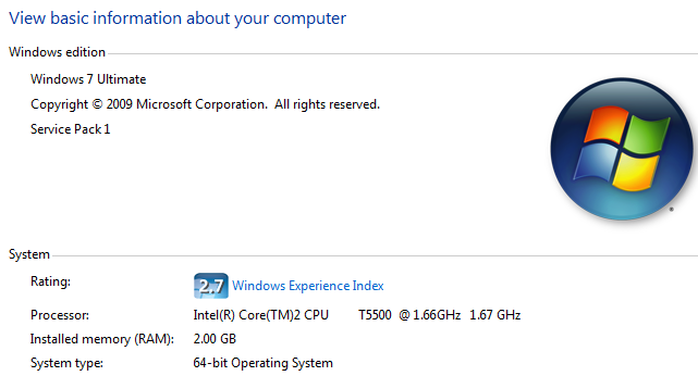

). I don't want to go any further since the drive only shows 746Gb. This is a 3TB HDD running on an Acer Aspire laptop (see "Win7Ult" snapshot
Windows 7 System Data
- it's not that great; but hey it works and does what I need of a laptop). So, while I am giving you views, I'll also show the Window's DiskManager graphic:
Disk Manager View of the drives.  Note the 2nd partition now shows as "RAW" where it used to be formatted as NTFS with a name like '3TB-2ndHalf'.
Note that Windows Disk Manager DOES recognize the drive as having 3TB (or 2794GB) and that the 2nd partition shows as RAW type.
I have done a lot of research and it appears perhaps I was misled on 3TB drives. Apparently, I am a victim of the >2TB issue that so many have encountered with these 'larger' drives. It's like deja vu all over again...
