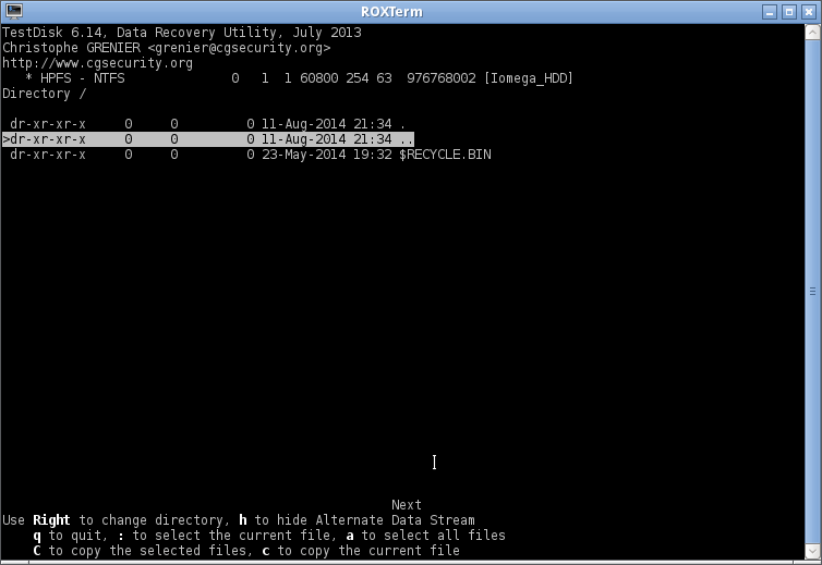

I have an other issue.Yesterday i wanted to shutdown my PC.
It takes a lot of time and just the circle turning and turning.
I switched(!) manuall a the power button.
But after my external HDD does not wanted to work fine more.
I began with the testdisk.fdsik -l was shown the right capacity and i even seen how
much is reserved so i was happy.I made a quick scan.But it tells me
error at XX..XXXX no partition found
After a while a saw my main folders,but i havent found anything in it,no files and no subfolders.
I made again quick scan but i got back the same error no partition found.
When i made the deeper scan it takes a lot of time to reach 1% it is strange
i don't have idea no what to do please help.
I can not make a checkdisk because the windows see as a RAW.
windows 7 does not want to shutdown after crashed usb HDD

Would it be possible to copy and paste the content of your testdisk.log into your next post?
At least I'd need info from TestDisk / Analyse about your current partition structure (partition table).
Also, how is your disk listed in your disk management console.
What's your OS and disk size?

Hello Fiona,Fiona wrote:Would it be possible to copy and paste the content of your testdisk.log into your next post?
thank you for your time.I was try to upload the log file,but i was amezed when checked the size of,it was more then 500 mb.
fdisk -l command shows:
Disk /dev/sdc - 500 GB / 465 GiB - CHS 60801 255 63
without start and end.
Don't really know for what reason.

Made a new scan see the result in the screenshoot
Still no files appeard
