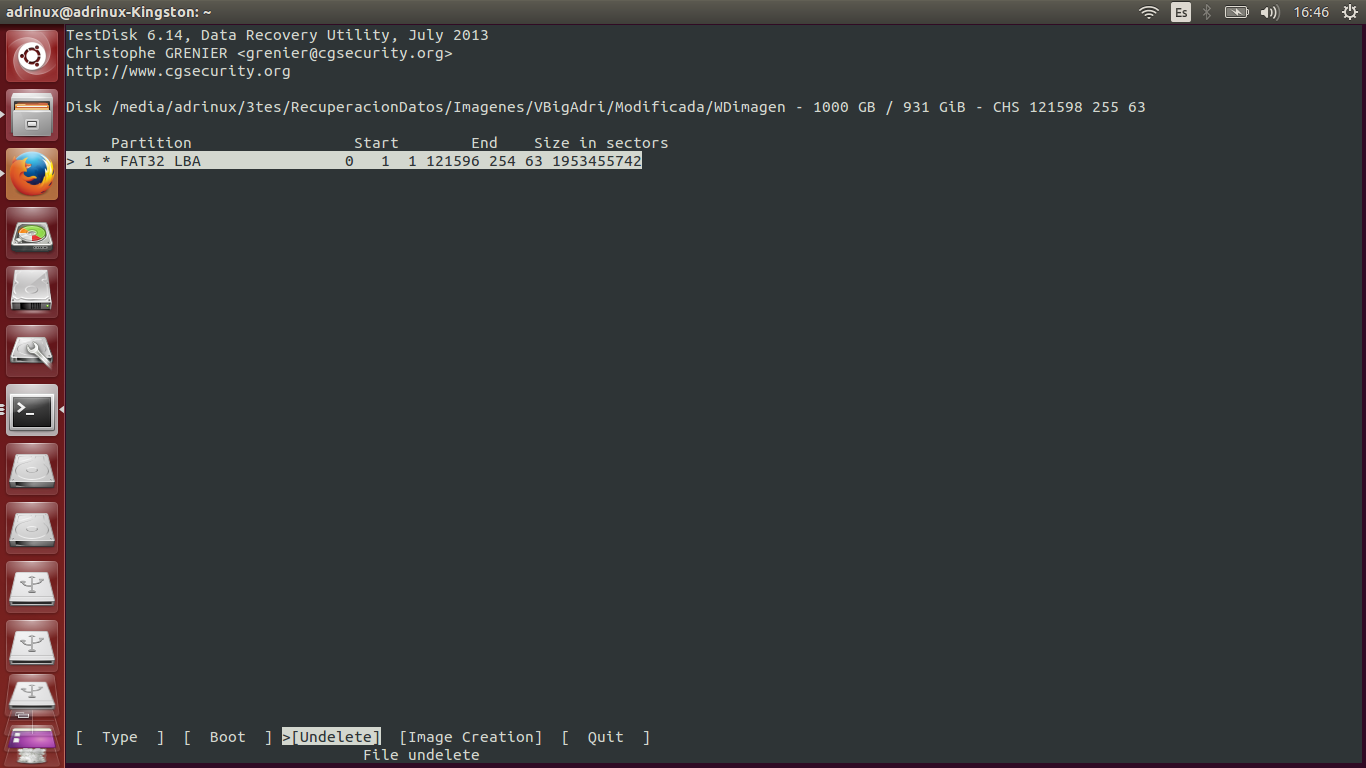

I ran TestDisk first on Windows and now on Ubuntu and it detects Intel/PC partition system, and when entering on the Analyse option shows the partition info:
Picture of the partition

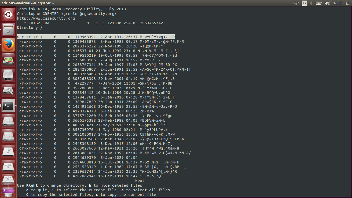

QuickSearch->P and I think that it shows the files following the data of a corrupted FAT:
Listed Files
Listed Files
These kind of strange names are the same (or similar) that I see when I plug in the device in Windows. Testdisk highlights some of the files in red.

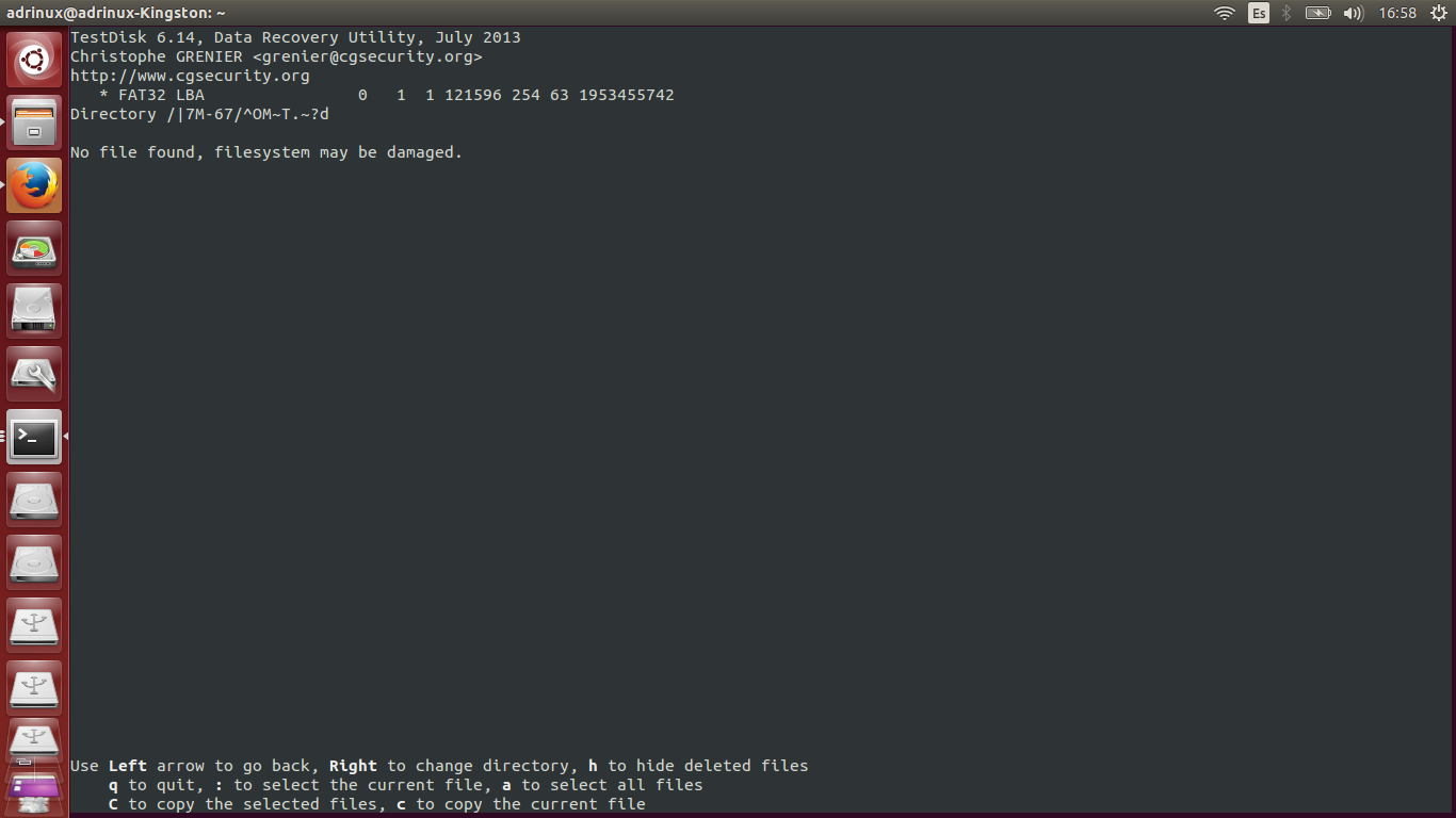

This is what happens when I try to enter in one of the directories shown on the picture:
File System damaged message
Thus I came to the conclusion that the FAT of the main partition has been corrupted and the system is not able to properly swim throw the file system. It shows random directories and it is not able to enter to the files because the pointers are random.
Now I ran the Advanced options, and boot sector and backup bootsector are Ok. It shows this message:
 1 * FAT32 LBA                0   1  1 121596 254 63 1953455742
OK
OK
First sectors (Boot code and partition information) are not identical.
Second sectors (cluster information) are not identical.
And here is where I am lost. I don't know what to do here. I have used the RebuildBS option just to see what happened though if the boot sectors are ok it doesn't make sense. I pressed the Automatic option and it came to the result that Extrapolated boot sector and current boot sector are different.
Am I wrong in some conclusion?
What should be my next step?
Thank you.
Re: Repair FAT of HDD
If you think the partition was using NTFS, in the Advanced menu of TestDisk, force the type to 7 HPFS-NTFS and try Boot, RebuildBS, List.
If it was a FAT32 or TestDisk failed, you can always try PhotoRec but it will not recover the original filenames.

The filesystem is FAT32. But what should I do now? Should I write the auto-extrapolated boot sector? Should I repeat the BuildBS and manually check all what TestDisk finds?...

Actually I was wrong. I checked the box of the HDD and it says "Formatted NTFS". I am doing what you said, right now it is searching the mft. Photorec is not very usefull because I don't get the name of the files nor the directories (and there were a lot of files) and I think that it does not recover all kind of files (like .dll, .css, .m...)
