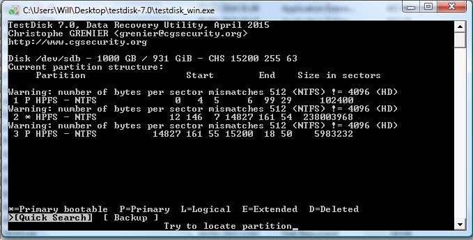

What do I do next? I don't think I can see this in the step by step.

Can you upload another photo from TestDisk / Analyse?
I'd like to check your current partition table (current partition structure and partitions.
The message structure bad often appears, if partitions overlap.
Runnung chkdsk on RAW partitions will only work if you have a valid boot sector.
Boot sector could be repaired, but if you're able to list your files, you should copy/backup your data first before you run chkdsk.
Please let me know, which partition contains your important data.

The above screenshot shows the screen I see after clicking on "Quick search".
The partition that contains all my files is the middle partition, as highlighted in green in the above screenshot.
I have also attached the testdisk log below:

Disk /dev/sda - 320 GB / 298 GiB - CHS 38913 255 63, sector size=512
Disk /dev/sdb - 1000 GB / 931 GiB - CHS 15200 255 63, sector size=4096
Disk \\.\PhysicalDrive1 - 1000 GB / 931 GiB - CHS 15200 255 63, sector size=4096
Drive C: - 311 GB / 290 GiB - CHS 37893 255 63, sector size=512
Drive E: - 974 GB / 907 GiB - CHS 14815 255 63, sector size=4096
Drive F: - 419 MB / 400 MiB - CHS 6 255 63, sector size=4096
Drive G: - 24 GB / 22 GiB - CHS 372 255 63, sector size=4096
Analyse Disk /dev/sdb - 1000 GB / 931 GiB - CHS 15200 255 63
NTFS at 0/4/5
Info: size boot_sector 819200, partition 102400
NTFS at 12/146/7
Info: size boot_sector 1904031744, partition 238003968
NTFS at 14827/161/55
Info: size boot_sector 47865856, partition 5983232
1 P HPFS - NTFS 0 4 5 6 99 29 102400
2 * HPFS - NTFS 12 146 7 14827 161 54 238003968
3 P HPFS - NTFS 14827 161 55 15200 18 50 5983232

Can you use the latest version of TestDisk 7.1WIP?
Your disk is recognized with 4096 Byte sector size, but your partitions with 512 Bytes only.
In rare cases it can cause that data are not recognized correctly.
Can you run another diagnose to test sector size of 512 Bytes on your disk?
You'll find it under the menu geometry.
Only change sector size.
Nothing else.
Please watch the message very dangerous at the bottom of the screen.
It means, that you shouldn't use Write under TestDisk nor Repair MFT to avoid any changes!
I strongly recommend it!
If you don't write something to your disk, you will not change nor modify something.
So you can change the value and it will be not written to your disk.
If you close TestDisk all settings will be lost.
At least it will be a try to list your data.
If they are listed, please let me know!
If it's successful, sector size could be written.
But only in case and info will follow.

Re: Help needed with TestDisk
Hi Fiona,
Ok, I will try to write the partition again, and set the 3rd partition as bootable.I will let you know the outcome ASAP.
You might be right, I haven't tried to put the hard disk back into my laptop yet, as I'm scared it might write things to it on boot up, but I might try that again. I did have a finger print security on my HP envy laptop (not the Bios log in thing).
Yes, you're right, the 1st partition only contains a "recovery" folder, whereas the 3rd partition contains lots of files, although I don't know what they're for.
With regards to your question about "on your first photos before you used TestDisk to write your partitions, your partitions were displayed as Intel and not as EFI GPT (UEFI).": I must admit, I don't really understand most of what you said as I'm only a beginner at this sort of things, but maybe it could be when my hard disk was first broken, I put the hard disk into a USB docking station and plugged it to my laptop, but because I couldn't see it under "My Computer" but I could see it under "Disk Management", and it said "unallocated" and also "uninitialized", it asked me to initialize and I think I selected "MBR (Master Boot Record)" and then clicked "OK", like this:
Sorry, I do not know what "UEFI" is or what GPT is, I just know there is two different type of partition called "MBR" and GPT".
All I have done since my hard disk was broken was the following steps:
1. Took Harddisk out of my laptop
2. Plugged it into a USB docking station and into a different computer
3. In Disk Management, it shows as uninitialized and unallocated, so I initialized it as selected "MBR (Master Boot Record)" and then clicked "OK" (This is probably a wrong move by me and maybe I shouldn't have done this without knowing what it actually does)
4. Used TestDisk to copy files back and backup everything I needed
5. Used TestDisk to set the middle partition as bootable, and then "Write" as per cgrenier's instructions
That is basically what I have done so far.
Thank you Fiona for your kind help again.
Hi Fiona,
This is what I tried tonight:
Before I follow your instructions, I thought I would try putting the hard disk back into my HP Envy laptop and see if it would work, but the message I got was this: So "Boot Device Not found".
Then I tried your advise and used TestDisk to set my 3rd partition as * (Primary bootable), and then pressed "Write" and restarted my computer. I then put the hard disk back into the HP Envy and try again, but again, same result, "Boot Device Not found."
So now I don't know what to do...
I look into Disk Management, and this is what I see now: and then I Googled what other people's HP Envy partitions look like and I found this image on the internet (http://h30434.www3.hp.com/t5/image/serv ... B?v=mpbl-1): If you compare both screenshots, you will similarities:
- 1st partition in both screenshot is 400MB
- 2nd partition is slightly smaller, but my says "Unallocated"
- 3rd partition is the biggest, and contains all the files, including the OS
- 4th partition is the smallest and probably the recovery partition
- the 2nd partition has "EFI", I don't know what this means.
Does that give any clue as to what I should do next? Please help.
Why do i have a 388MB black "Unallocated" partition in Disk Management?
Thank you once again.
Looks like that the second partition is an EFI-Bootpartition.
Disk size is different, your one 1 TB and 500 GB.
Normally the file system of that efi partition is FAT?
It's not available on your disk.
You can try to convert your disk to GPT and start another diagnose using TestDisk and have a try to find it too.
You must use your disk management console to delete all partitions.
After deleting, rightclick into the left little square and convert it to GPT.
After converting, an applet of your disk management console will appear and suggest to create partitions.
Don't do it and stop it.
There is no necessity, because TestDisk should search for partitions and recover the original ones.
Please use the latest TestDisk 7.1WIP.
As far as I know, yesterday was a new beta released.
On GPT-partition TestDisk will scan each sector and might be a little bit time consuming.
The latest beta can be a faster.
Run TestDisk / Analyse and Quick Search.
GPT-Partitions under TestDisk appear with different names like MS Reserved and MS Data.
Keep an eye on that small missing efi partition.
If you still miss it, please run Deeper Search also.
I'd need the result of the Search.
Don't use Write as far.
I've to check your efi-partition.
Might be possible that your efi-FAT-partition is listed as a normal FAT-Partition.
In case, it could be necessary to change the partition type to efi.
Info will follow.
Important:
I already asked you, did you create Recovery-DVD's
Should be the first thing after buying a laptop.
You should try to do something first.
Put your disk into your laptop.
Have a try to start into recovery mode.
Please let me know, did it work.
You'll find a description in your manual.
Then intention is, to create recovery-DVD's and is recovery available?
Manufacturer often offer that Recovery-DVD's can be ordered.
On the other hand:
Your partitions appear as RAW, but you can list all data.
Even the recovery data.
TestDisk could copy them off of your disk.
I've had one case, he was able to execute recovery and create Recovery-DVD's
Recovery will set back your laptop to factory settings.
Might be possible that you can start recovery after converting your disk back to gpt and create recovery-DVD's?
There are lots of questions.
But first of all try to boot into the recovery mode.
You can consider to copy recovery data.
Otherwise convert it to GPT and have another try after partition recovery.
Although I've no idea, did you create any recovery-DVD's?
Also I've no idea, did HP already deliver software and recovery-DVD's with your laptop?
Info will follow.
Important:
On the other hand:
