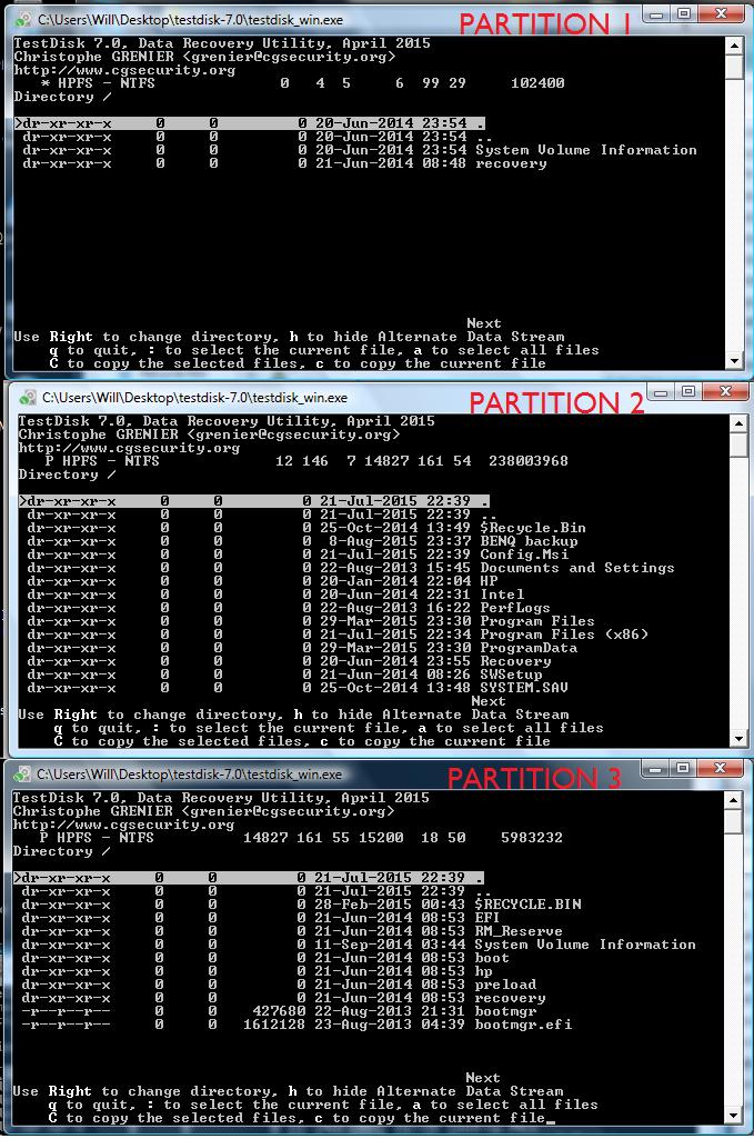

What do I do next? I don't think I can see this in the step by step.

Re: Help needed with TestDisk
The above screenshot shows the screen I see after clicking on "Analyse" on the "Disk /dev/sdb - 1000 GB / 931 GiB" drive.
The above screenshot shows the screen I see after clicking on "Quick search".
The partition that contains all my files is the middle partition, as highlighted in green in the above screenshot.
I have also attached the testdisk log below:

1 P HPFS - NTFS 0 4 5 6 99 29 102400
2 * HPFS - NTFS 12 146 7 14827 161 54 238003968
3 P HPFS - NTFS 14827 161 55 15200 18 50 5983232
Thank you for your help.
Hi Fiona, yes ok, I will try using the latest beta version of TestDisk 7.1-WIP tonight and let you know the result.

Have a look at your third partition:
http://forum.cgsecurity.org/phpBB3/down ... hp?id=3392
You can consider to make it bootable and test it.
Compare with your first partition it only contains a folder called recovery:
There are no boot files but it was set to star for active and bootable.
It would be worth a try to change it and write your partitions using testdisk again.

Also, I've seen that your first partition does not contain any boot files.
But the third partition contains some.
You should run Analyse and Quick Search.
Set your third partition as described above to Star * for active.
Set the other two partitions to P for primary only.
Use TestDisk to write your partitions.
Put your disk back into your laptop and try to boot.
Please let me know.

Ok, I will try to write the partition again, and set the 3rd partition as bootable.I will let you know the outcome ASAP.
You might be right, I haven't tried to put the hard disk back into my laptop yet, as I'm scared it might write things to it on boot up, but I might try that again. I did have a finger print security on my HP envy laptop (not the Bios log in thing).
Yes, you're right, the 1st partition only contains a "recovery" folder, whereas the 3rd partition contains lots of files, although I don't know what they're for.
With regards to your question about "on your first photos before you used TestDisk to write your partitions, your partitions were displayed as Intel and not as EFI GPT (UEFI).": I must admit, I don't really understand most of what you said as I'm only a beginner at this sort of things, but maybe it could be when my hard disk was first broken, I put the hard disk into a USB docking station and plugged it to my laptop, but because I couldn't see it under "My Computer" but I could see it under "Disk Management", and it said "unallocated" and also "uninitialized", it asked me to initialize and I think I selected "MBR (Master Boot Record)" and then clicked "OK", like this:
Sorry, I do not know what "UEFI" is or what GPT is, I just know there is two different type of partition called "MBR" and GPT".
All I have done since my hard disk was broken was the following steps:
1. Took Harddisk out of my laptop
2. Plugged it into a USB docking station and into a different computer
3. In Disk Management, it shows as uninitialized and unallocated, so I initialized it as selected "MBR (Master Boot Record)" and then clicked "OK" (This is probably a wrong move by me and maybe I shouldn't have done this without knowing what it actually does)
4. Used TestDisk to copy files back and backup everything I needed
5. Used TestDisk to set the middle partition as bootable, and then "Write" as per cgrenier's instructions
That is basically what I have done so far.

I've seen that your third partition contains some files like efi.
That's why I assume that your disk was GPT.
I'd rather converting it.
I already wrote some info about it in my post above.
In case, please let me know, when I can guide you through.

Before I follow your instructions, I thought I would try putting the hard disk back into my HP Envy laptop and see if it would work, but the message I got was this: So "Boot Device Not found".
Then I tried your advise and used TestDisk to set my 3rd partition as * (Primary bootable), and then pressed "Write" and restarted my computer. I then put the hard disk back into the HP Envy and try again, but again, same result, "Boot Device Not found."
So now I don't know what to do...
I look into Disk Management, and this is what I see now: and then I Googled what other people's HP Envy partitions look like and I found this image on the internet (http://h30434.www3.hp.com/t5/image/serv ... B?v=mpbl-1): If you compare both screenshots, you will similarities:
- 1st partition in both screenshot is 400MB
- 2nd partition is slightly smaller, but my says "Unallocated"
- 3rd partition is the biggest, and contains all the files, including the OS
- 4th partition is the smallest and probably the recovery partition
- the 2nd partition has "EFI", I don't know what this means.
Does that give any clue as to what I should do next? Please help.

Looks like that the second partition is an EFI-Bootpartition.
Disk size is different, your one 1 TB and 500 GB.
Normally the file system of that efi partition is FAT?
It's not available on your disk.
You can try to convert your disk to GPT and start another diagnose using TestDisk and have a try to find it too.
You must use your disk management console to delete all partitions.
After deleting, rightclick into the left little square and convert it to GPT.
After converting, an applet of your disk management console will appear and suggest to create partitions.
Don't do it and stop it.
There is no necessity, because TestDisk should search for partitions and recover the original ones.
Please use the latest TestDisk 7.1WIP.
As far as I know, yesterday was a new beta released.
On GPT-partition TestDisk will scan each sector and might be a little bit time consuming.
The latest beta can be a faster.
Run TestDisk / Analyse and Quick Search.
GPT-Partitions under TestDisk appear with different names like MS Reserved and MS Data.
Keep an eye on that small missing efi partition.
If you still miss it, please run Deeper Search also.
I'd need the result of the Search.
Don't use Write as far.
I've to check your efi-partition.
Might be possible that your efi-FAT-partition is listed as a normal FAT-Partition.
In case, it could be necessary to change the partition type to efi.
Info will follow.
