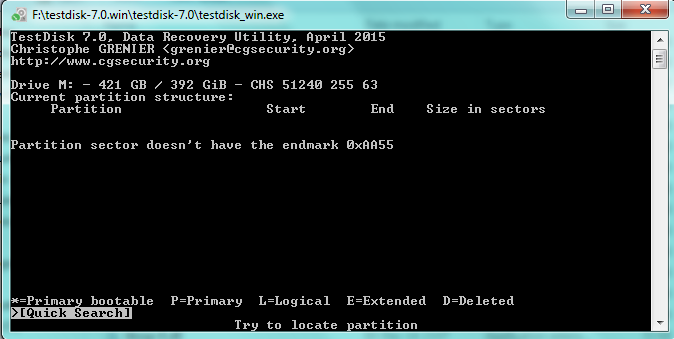

here it shows
im
TestDisk 7.0 Data Recovery...........
Chris Gernier<.........>
Drive M: - 421 GB / 392 GiB - CHS 51240 255 63, sector size=512
Analyse Drive M: - 421 GB / 392 GiB - CHS 51240 255 63

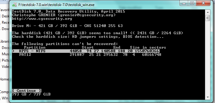

Next did a Quick Search
result is
The Harddisk <421GB/392GB> seems too small! <<2431GB/2264BiB.
> HPFS - NTFS 44058 94 27 140588 188 20 1550760366
FAT12 291887 25 21 295632 78 4 60166748
it doesnt matter if i select HPFS -NTFS or FAT12 it shows
>* HPFS - NTFS 2549 196 16 27408 133 53 399355904
press P to list files.
Here comes the problem
It shows only my 3rd Partition 170GB. i recovered some files thank you.
2nd partiton of 202GB doesnt appear.
did a deep scan same result

Re: Two Partition got combined to form Single RAW
Drive is like a single partition and has no partition table.
Can you run another diagnose selecting your disk instead of a drive?
So you would run your diagnose on your disk, containig your MBR/GPT.
TestDisk 7.1WIP 32bit is recommended.
RAW indicates a problem with your boot sector or file system.
But before I go, to run a boot sector diagnose on any partition, it's always advisable to check your partition table to see, that I run a diagnose on your right partition.
If your partition doesn't fit like start and size, you wouldn't get any reliable result.
I suggested to select disk instead of a drive, but now you used PhysicalDrive.
Might be almost ok, but often indicates that user are running testdisk 64bit on windows?
In some cases, Disk is not available.
On TestDisk download section, there is a note, testdisk 64bit should only be used on genuine 64bit machines (for example like Itanium) as some features are missing.
Genuine 64bit machines have no 32bit emulation like WoW64.
But you're running Windows 7.
That's why I recommend to use TestDisk 7.1WIP 32bit.
Probably, your disk would be listed there as Disk / dev /sd* ?
Despite that, testdisk delivered different results in comparison to drive.
You can watch it here:
Analyse under Drive:
Partition sector means, that your partition is not valid or available.
Running diagnose on PhysicalDrive:
The last partition appears twice.
Reason is, there is a message that NTFS or EXFAT boot is not valid and testdisk is listing your affected partition too.
So it might be possible that this is the culprit?
Next step would be to run a boot sector diagnose.
In case, use testdisk 7.1WIP 32bit and select Disk / dev ... !
Select your affected partition and confirm at Boot.
Please upload a snapshot or copy and paste the content of your log again.
Don't run any RepairMFT.
It's only intended in conjunction with chkdsk.
If the menu "List´is available, please have a try to list your files.
Info will follow.
There is no partition listed.Analyse Drive M: - 421 GB / 392 GiB - CHS 51240 255 63

1 P HPFS - NTFS 0 1 1 0 32 32 1985
2 * HPFS - NTFS 0 32 33 12 223 19 204800
3 P HPFS - NTFS 12 223 20 9561 7 46 153391104
NTFS, blocksize=4096, 78 GB / 73 GiB
4 P HPFS - NTFS 9561 7 47 60801 48 31 823173168
ntfs_boot_sector
filesystem size 4944423188294718101 1
sectors_per_cluster 154 0
mft_lcn 127794666 0
mftmirr_lcn 1946432275 0
clusters_per_mft_record 86 0
clusters_per_index_record -24 0
Status: Bad
Status: Bad
Sectors are not identical.
Not an exFAT boot sector.
I'm on your snapshot here:
http://forum.cgsecurity.org/phpBB3/down ... hp?id=3492
Your boot sector and its backup are bad.
Can you run RebuildBS?
If it takes too long, please let me know.
Can be possible that your partition is not the right one?
In some cases, partition start and size got changed and caused such behavior.
In case, you should run Quick and Deeper Search to have a try to find the right one.
But at the moment run RebuildBS first.
TestDisk tries to rebuild a boot sector searching your MFT and its mirror.
If it would be succesful, TestDisk would display the result of an extrapolated boot sector and the menu List could appear.
You can select it, and have a try to list your files.
If it doesn't work for you, you should run Quick and Deeper Search to have a try to find the right partition.
Info will follow.
Info will follow.
hi thanks again for replying fast. RebuildBS takes long time
I did Quick Search and deep search .Result is attached.
Look there was 2 partition one 200GB other 170 GB. now its combined to 370 RAW
I can List the files of 2nd partition 170GB and also recover all the files but cant do that of 200GB partition.
I am using other software (don't know weather i can name them in forum) .There it shows both the partition separately.those are trial version. cant recover anything(i post screenshot if u want)
Most of my important files are there in 200GB partition. Here is the log result

Invalid NTFS or EXFAT boot
Warning: number of heads/cylinder mismatches 33 (NTFS) != 255 (HD)
Warning: number of sectors per track mismatches 32 (NTFS) != 63 (HD)
NTFS at 0/32/33
filesystem size 204800
mft_lcn 8533
mftmirr_lcn 2
NTFS at 12/223/20
heads/cylinder 33 (NTFS) != 255 (HD)
sect/track 32 (NTFS) != 63 (HD)
filesystem size 153391104
mftmirr_lcn 2
NTFS at 12110/203/62
filesystem size 399355904
mftmirr_lcn 2
HPFS - NTFS 12110 203 62 36969 141 36 399355904
NTFS, blocksize=4096, 204 GB / 190 GiB
BAD_RS LBA=547796906 868526
file_pread(5,3,buffer,547796906(301448/33/4)) lseek err Invalid argument
file_pread(5,1,buffer,547796906(301448/33/4)) lseek err Invalid argument
FAT12 301448 33 4 305193 85 50 60166748
This partition ends after the disk limits. (start=4842764202, size=60166748, end=4902930949, disk end=976773167)

The harddisk (500 GB / 465 GiB) seems too small! (< 2510 GB / 2337 GiB)
HPFS - NTFS 53619 102 10 150149 196 3 1550760366
P HPFS - NTFS 12110 203 62 36969 141 36 399355904

Sat Oct 17 17:13:25 2015
TestDisk 7.1-WIP, Data Recovery Utility, September 2015
OS: Windows 7 (7600)
Compiler: GCC 4.9, Cygwin 2002.0
Compilation date: 2015-10-11T15:23:01
disk_get_size_win32 IOCTL_DISK_GET_LENGTH_INFO(/dev/sdb)=500107861504
disk_get_size_win32 IOCTL_DISK_GET_LENGTH_INFO(\\.\PhysicalDrive1)=500107861504
disk_get_size_win32 IOCTL_DISK_GET_LENGTH_INFO(\\.\C:)=48318382080
disk_get_size_win32 IOCTL_DISK_GET_LENGTH_INFO(\\.\D:)=32211206144
disk_get_size_win32 IOCTL_DISK_GET_LENGTH_INFO(\\.\E:)=204472320000
disk_get_size_win32 IOCTL_DISK_GET_LENGTH_INFO(\\.\F:)=215101734912
disk_get_size_win32 IOCTL_DISK_GET_LENGTH_INFO(\\.\H:)=1016320
filewin32_getfilesize(\\.\I:) GetFileSize err Incorrect function.
filewin32_setfilepointer(\\.\I:) SetFilePointer err Incorrect function.
disk_get_size_win32 IOCTL_DISK_GET_LENGTH_INFO(\\.\J:)=104857600
disk_get_size_win32 IOCTL_DISK_GET_LENGTH_INFO(\\.\K:)=78536245248
disk_get_size_win32 IOCTL_DISK_GET_LENGTH_INFO(\\.\M:)=421464662016
Disk /dev/sda - 500 GB / 465 GiB - CHS 60801 255 63, sector size=512 - ST950032 5AS, S/N:2SRWP3X9, FW:0011
Disk /dev/sdb - 500 GB / 465 GiB - CHS 60801 255 63, sector size=512 - Generic External, S/N:MSEE235V3Z1SHW, FW:1.14
Disk /dev/sdb - 500 GB / 465 GiB - Generic External
NTFS at 0/32/33
NTFS at 12/223/20
NTFS at 0/32/33
mft_lcn 8533
mftmirr_lcn 2
NTFS at 12/223/20
mftmirr_lcn 2
mftmirr_lcn 2
BAD_RS LBA=861395670 9139340
This partition ends after the disk limits. (start=861395670, size=1550760366, end=2412156035, disk end=976773167)
file_pread(5,3,buffer,976773182(60801/81/15)) lseek err Invalid argument
file_pread(5,1,buffer,976773182(60801/81/15)) lseek err Invalid argument
file_pread(5,8,buffer,976773198(60801/81/31)) lseek err Invalid argument
file_pread(5,11,buffer,976773245(60801/82/15)) lseek err Invalid argument
file_pread(5,2,buffer,976775167(60801/112/47)) lseek err Invalid argument
file_pread(5,1,buffer,976773206(60801/81/39)) lseek err Invalid argument
file_pread(5,1,buffer,976773256(60801/82/26)) lseek err Invalid argument
file_pread(5,1,buffer,976775169(60801/112/49)) lseek err Invalid argument
file_pread(5,14,buffer,976775170(60801/112/50)) lseek err Invalid argument
file_pread(5,3,buffer,976775184(60801/113/1)) lseek err Invalid argument
file_pread(5,3,buffer,976775231(60801/113/48)) lseek err Invalid argument
file_pread(5,8,buffer,976775247(60801/114/1)) lseek err Invalid argument
file_pread(5,11,buffer,976775294(60801/114/48)) lseek err Invalid argument
file_pread(5,2,buffer,976777216(60801/145/17)) lseek err Invalid argument
dir_partition inode=5
