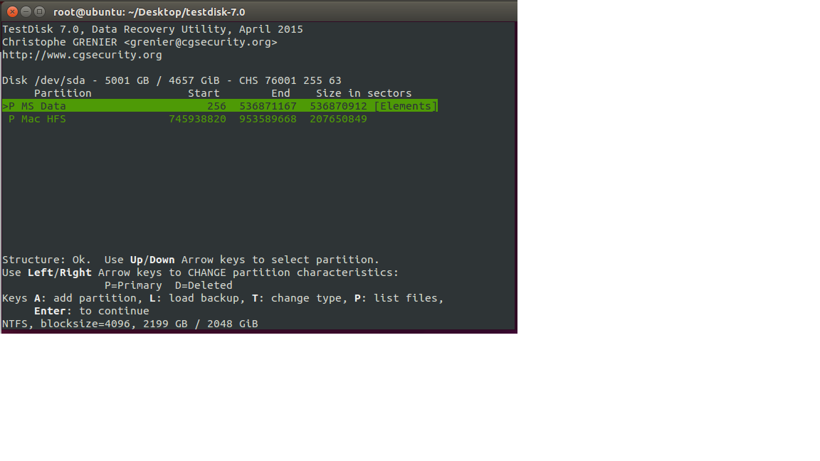

Here is a screenshot I do not understand. In the attached picture at the bottom it says blocksize=4096, 2199GB / 2048 GiB. Why does it say that? I could not find what "Sector Size" to put.
Typically sign that your partition is only recognized as a 2.2 TB (2199 GB)-partition.

The 2.2GB is show in TestDisk if I choose Intel partition and run Analyse. After Analyse finishes and I press P I can view all the files on the HDD. Above where the partitioned are listed I see Disk /dev/sda - 5000 GB / 4657 GiB. Which seems to be normal for a 5TB HDD.
But underneath where it says: Keys A: add partition ... and so one it says: NTFS, blocksize=4096, 2199GB / 2048 GiB. TestDisk finds all the files and I can copy them (I presume correctly) but it decides to write a wrong partition table at the end, a partition table that only indexes(?) 2048 GiB. I do not understand why?

Now, I tried your suggestion of using GPT partition instead. It does the same thing but it finds 2 partitions. 1 MS Data and 1 Mac HFS. The Data partition has all the files, again found correctly and I can copy them but it again says on the bottom that the HDD is only 2048 GiB despite finding the correct size at the top: Disk /dev/sda - 5001 GB / 4657GiB. Why would it find correctly the partition but decide to write the wrong one? If I select to proceed and write the partition information it says "Error".
