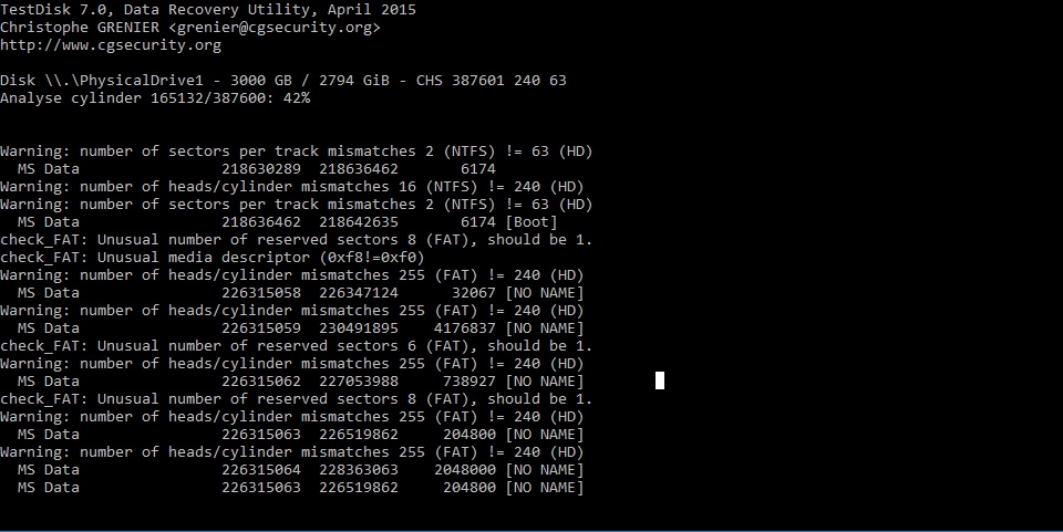

Done. it is recognized (correctly i guess) as GPT.
Quick search finds a single MS data partition
a Deeper Search takes two and a half days (currently at 5%)... and finds many partitions. by the way i had to restart this long long process twice already because of some bug, when i maximize the window all the text disappears...
the log as of now, it is incomplete because it is very long. the full log is here: https://www.dropbox.com/s/l8ot13il4vm76 ... k.log?dl=0

Re: Partition mess and 3TB turns to 5TB
can anyone help? deep search is still running since my first post and now at 42%
do i really need to wait for it to finish?
- Untitled.jpg (142.02 KiB) Viewed 2293 times
