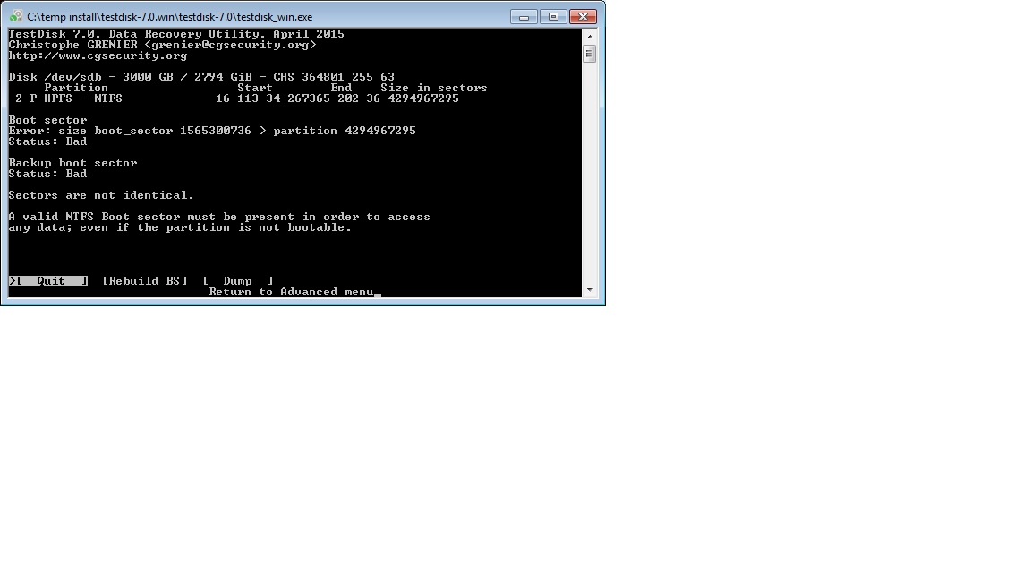

The thing is the wiki is not clear how to go to the menu to change/check boot sector. (perhaps because i was on 64 bit version, i now used the normal one)
I found one menu, but it seems to be on the big partition, and both Boot sector and backup sector are corrupted.
I wonder If W7 overwrote them because of the 100 Mos partition, or If my first try at restoring allocation table impacted it.

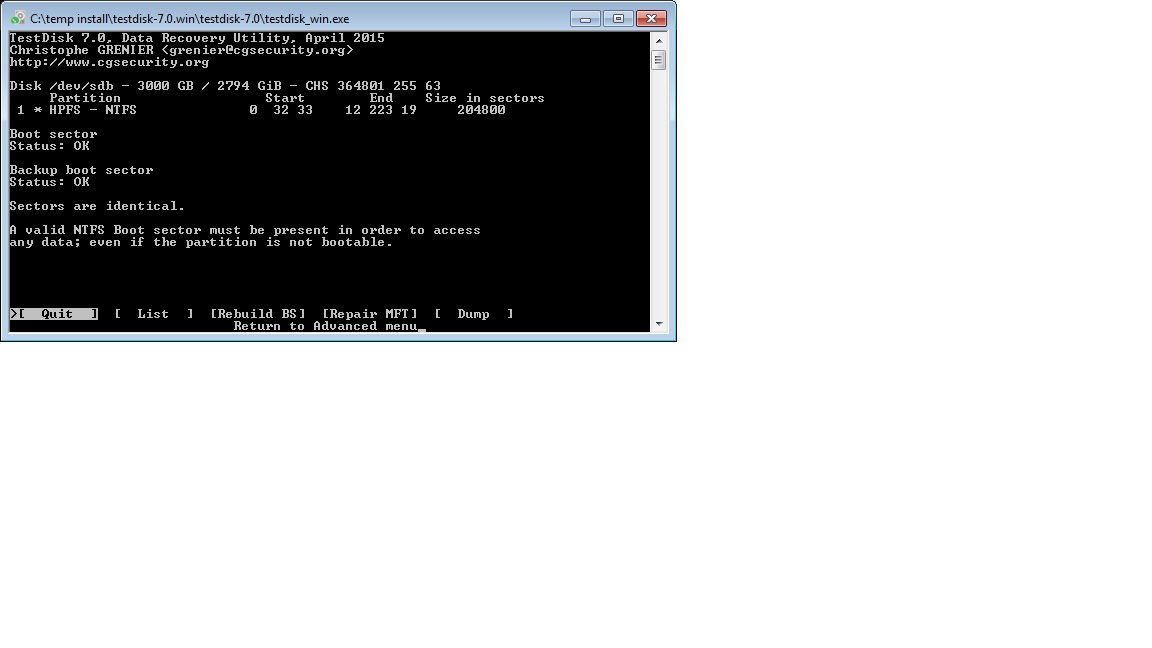

In addition, the smal partition is tagged bootable but I do not want to use it to boot.

Should i use the adanced option and "Rebuild Bs" on the big partition?
Should I change the type of the small partition to Primary (P) instead of Bootable (*) ?
Should i just delete this small partition as I already have a Sytem reserved on "D" and it is useless or do i need to keep it (not sure if is used to store allocation table, or if it is to store windows security data) ?

Assuming the partition table is ok. In Advanced, you can select the second partition, choose Boot, RebuildBS, List.
If you can see your files, choose Write, confirm, Quit and reboot
If it doesn't work, maybe the partition table is wrong, use Analyse, Quick Search and if your partition isn't listed, choose Deeper Search.
Use the arrow keys to switch the partition you want to keep from D(eleted) to P(rimary). On next screen, choose Write, confirm, Quit and reboot.
