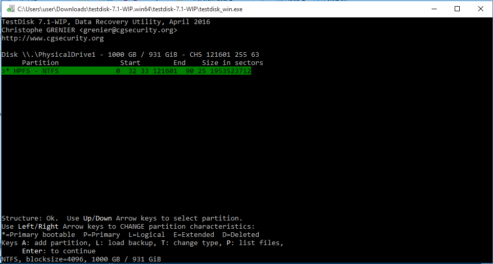

Please I need help, I was lucky to come across TestDisk and PhotoRec some hours ago. I have hope that I can restore my Seagate 1TB external drive.

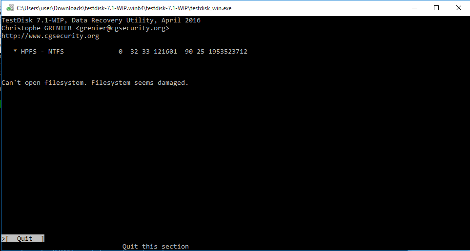

I got hooked with TestDisk when I got this "Can't open filesystem. Filesystem seems damaged."

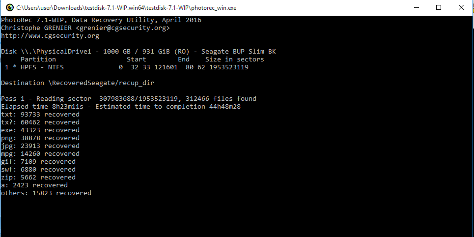

So I tried PhotoRec, right now photoRec is recovering my files unto my C drive, It has created over 250 folders already with diffrent file types and strange names.
I would like to restore my Seagate 1TB to its last working state even after PhotoRec has finishes its work. Please what can do I do to achieve this.
Please see images below for perhaps helpful information...
- Image 1
- TESTdISKrESULT.png (21.55 KiB) Viewed 13279 times
- Image 2
- TESTdISKrESULT2.png (13.76 KiB) Viewed 13279 times
- Image 3:
- TESTdISKrESULT3.png (22.82 KiB) Viewed 13279 times
Re: Filesystem seems damaged
Try the following: run "cmd" (right click run as administrator) and "chkdsk /f d:" (replace d: by the correct drive letter)
Thanks. I have my Seagte 1TB data back, Chkdsk worked.
