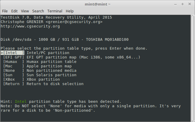

I started using TestDisk after I broke the dual boot of my laptop (Windows 10 Creators update + Linux Mint 18.2).
After having started TestDisk, I got this:
Test Disk Intel 2.png (67.6 KiB) Viewed 9602 times

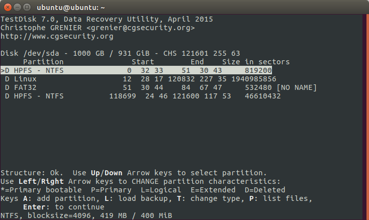

And then after I chose HPFS - NTFS and pressed Enter, I got that (Deep Search 30% completed but still running):
Deep Search 30.png (53.04 KiB) Viewed 9602 times
I noticed that all partitions are deleted and duplicated as well.
Would you suggest to delete the duplicates?
Thank you all,
William
Re: Partitions broken and duplicated
You are currently looking for lost/deleted partitions. Assuming it's your problem, you will have to use the arrow keys to switch the partitions to keep/recover from D(eleted) to P(rimary), L(ogical) or *(bootable). If the generated partition table is ok, choose Write, confirm, Quit and restart your computer.

So first, in order to retrieve Windows 10, I chose Intel instead of EFI GPT.
Testdisk 2.png (54.27 KiB) Viewed 9584 times

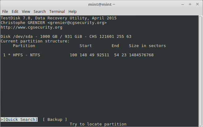

Then I get this screen with all partitions deleted:
Test disk 3.png (60.39 KiB) Viewed 9584 times
Then I chose the first partition and start a deeper search.
I selected the biggest deleted partition which corresponds to the Windows partition and set it as boot:
Set HPFS - NTFS as boot.png (35.44 KiB) Viewed 9583 times
Let's see how it goes.
Thanks for your support !!
#6 Post by cgrenier »
As your partitions overlaps, copy the files you want to keep/recover on another disk and once it's done, set the partition you want to keep as *(bootable) or P(rimary).
When finished, choose the partition table, and reinstall an OS (Windows or Linux Mint) in the unallocated space.
