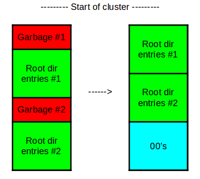

Finally, I achieved recovering my broken filesystem following your advice. I created a test filesystem as you suggested, and with the help of it and this Wikipedia article: https://en.wikipedia.org/wiki/Design_of ... ile_system I could understand the basics of a FAT32 filesystem and compare it's structure with the broken one. With this, I have edited the root directory cluster. I have attached how the root directory cluster beginning looked before editing and after editing. What could be the origin of these blocks marked as garbage?
With the root cluster edited, I ran Testdisk and this time it recognized the root directory without asking me anything. I just checked from the built-in file browser that I could access folders and data and chose to write boot sector. Now the SD card is recognized in both computer and phone, and so far everything is right. So now it's matter of having good backup practices avoiding this happening again, as this time I have been very lucky. Is there any recommended guide about having backups organized and prevent wasting space and/or losing data?
Many thanks for your help and to everyone who has participated in the development of Testdisk and Photorec.
