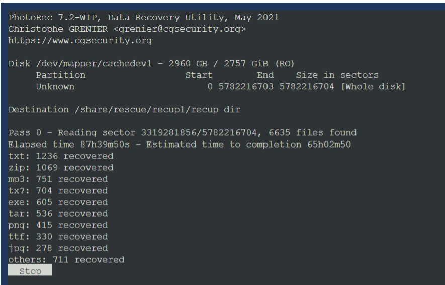

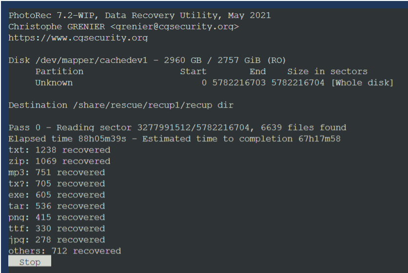

I'm trying to recover a 3TB disk after being hit by QLocker.
I'm using photorec bundled into QRescue.
Obviously, this is going extremely slow, I can't even remember how many days (definitely more than a week) have passed now...
It's now at around 55% by sector count, and got even slower. What I noticed, that now it keeps jumping back by 100-150 million (!) sectors from time to time, usually right after it reports a new file found just a few sectors after the previous place it jumped back from.
I don't remember seeing this happening in the earlier, lower sectors.
This observation is backed by the number of recup dirs being created by each day. For the first couple of days it was hundreds of new dirs per day, but now it is only increasing by 1 or 2 new dirs each day.
There are ~4200 dirs created in relatively quick succession (reaching ~3.19B sectors) in around 6-7 days, but only around 20 in the last 5 days. The most recent files are from sectors in the 3.39B range. That's 200M (0.2B) sector progress for these last 5 days altogether. At this rate, it might take several more weeks to finish, so I'm quite concerned.
Any tip on what might be going on and how to overcome this behavior?
See some images: https://imgbox.com/g/HOd94kD3IO
Photorec 87h39m 3.319B.PNG (114.03 KiB) Viewed 29049 times
Photorec 88h05m 3.277B.PNG (113.47 KiB) Viewed 29049 times
You can see, the "elapsed time" and "files found" increased, but the sector counter is lower.
(Ignore the actual elapsed time value, I had to restart the device. So this only shows the latest session, not the total actual time.)
