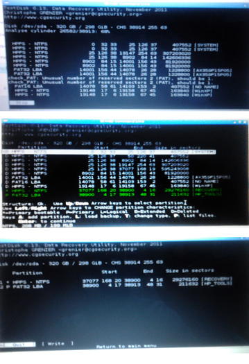

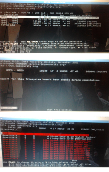

I ran TestDisk v6.13 which seems to have found the Recovery Partition but not the Windows 7 Partition. The following screenshots illustrate what I've found:
The 1st Screenshot above shows the 1st, 2nd and 3rd entries/partitions are ALL not accessible - I'm assuming they all are damaged.
In the 2nd Screenshot above, when listing each of the entries via the "p" command (Print/List files) I get the following error message as shown in the screenshot: "Support for the filesystem hasn't been enable during compilation"
In the 3rd screenshot above - the FAT32 Partition (LBA) HP_TOOLS shows the file listing - I'm assuming the RED files are inaccessible. Is this correct?
The next screenshot above shows the results after selecting "Deeper Search" option. This clearly shows I have at least 1 partition that is corrupted.
The next screenshot above shows 2 partitions in GREEN that seem to indicate these partitions can be repaired by TestDisk.
The last screenshot seems to allow me to WRITE the two GOOD partitions - which I'm assuming will allow me to then at least BOOT the Recovery Partition and the HP Tools Partition - is this correct? I'm also assuming based on the above screenshots - my Windows 7 partition seems not to be recoverable by TestDisk - is this correct?
My final question is - if I do proceed with WRITING these two partitions will I then be able to RESTORE/RECOVER my Windows 7 partition?

Your photos are almost not readable.
Looks like that you used the 64bit-version.
Would it be possible to use TestDisk 6.14-32bit and repeat your diagnose?
There is a description on the download page that the 64bit-version should only be used on machines lacking WOW64 as some features are not available!
