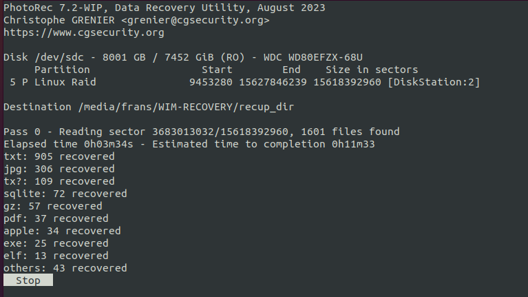

EDIT: after this I figured that I of course set a breakpoint at this line, examine file_size; skip the line, then set file_size to the value obtained just before.
The breakpoint was hit a few times and afterwards it continued and I got an avi file recovered.
Triggered by this I decided to make the change in this code and - lo and behold - recovering continues.
I did notice a small UI issue after recovering though.
The estimated time to completion is very short; see attachment.
I suspect this is due to taking the time from the very first sector to the sector we are and then estimate based on the remaining number of sectors.
However probably we need to take the number of sectors that were read since recovery and calculate based upon that.

- Screenshot from 2023-12-21 22-51-55.png (70.47 KiB) Viewed 143613 times

A few other remarks.
I already reported that when restarting with a .ses file that the estimate is wrong.
I found where this happens, it is in phnc.c where it says:
120 const time_t eta=(partition->part_offset+partition->part_size-1-offset)*elapsed_time/(offset-partition->part_offset);
121 wprintw(window," - Estimated time to completion %uh%02um%02u\n",
122 (unsigned)(eta/3600),
123 (unsigned)((eta/60)%60),
124 (unsigned)(eta%60));
I feel in line 120 the part
should be replaced with something like
(offset -offset-where recovery-started)
However I did not find a variable that gives the offset where the recovery started.
