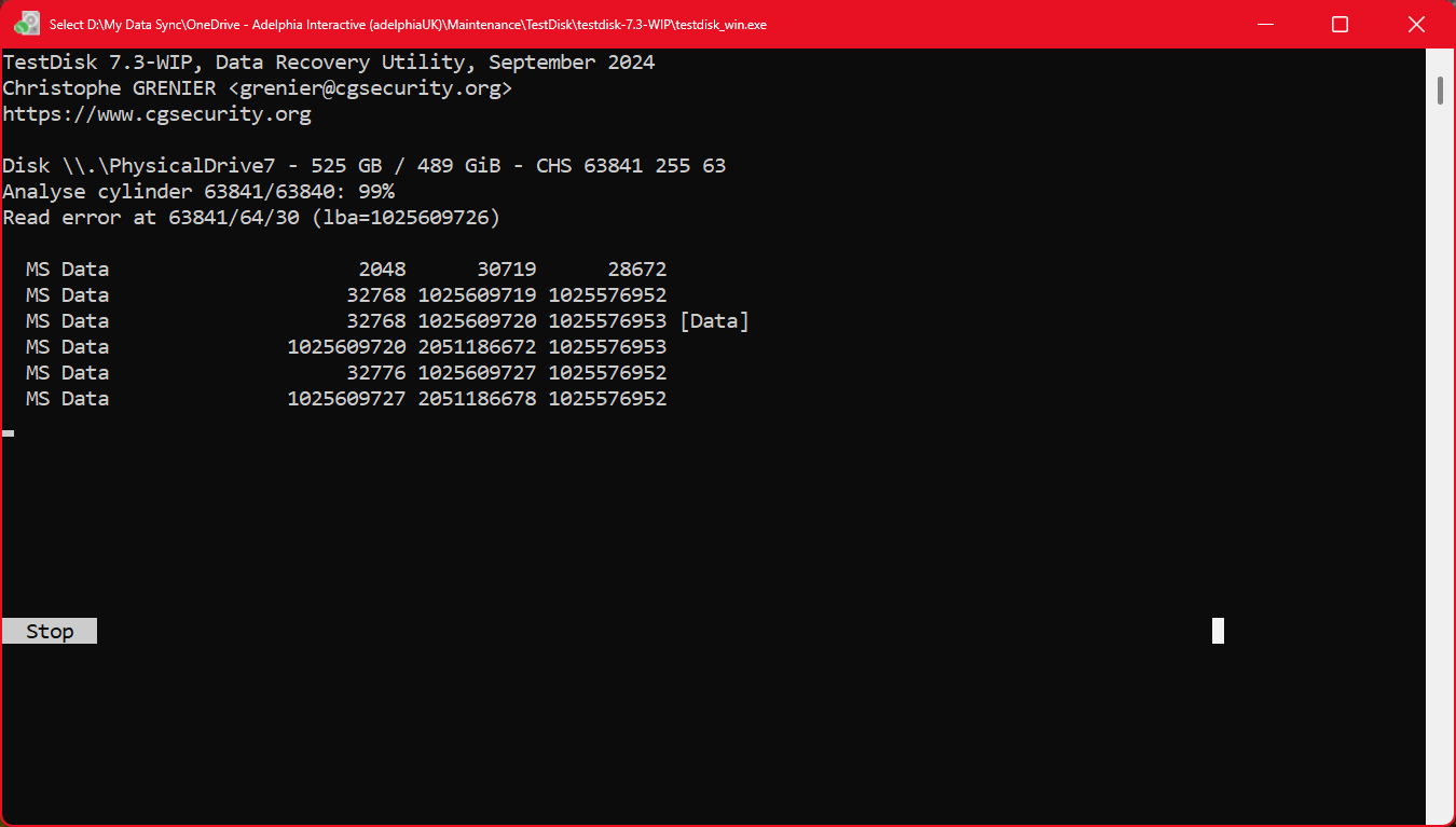

The first app I've tried of yours is test-disk-7.3-WIP (which I know means Work In Progress) but it appears to have hung.
[img htps://avatars.adelphia.co.uk/testDiskWindow.png]As shown here[/img]
But how do I know that? All the counters are static, and I can't click stop. I don't really want to close the window otherwise I'll lose where I got to and have to start over.
Do you have any suggestions?

Here is your picture.
Please post your log file.
The term "read error" on the picture suggests following the standard procedure:
Post your smartmontools log file:
viewtopic.php?f=5&t=10910
Depending on the result it might be necessary to clone the drive as described in the manual.
