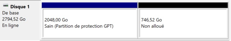

Each drive had initially one 3tb GPT partition when plugged to the USB docking station. When i plugged them into my other USB external enclosure (not docking station), 2 partitions showed up. One 2048Go GPT protection partition and the other 746.52 Go unallocated.

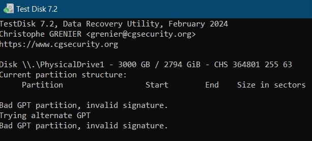

After selecting EFI GPT (instead of automatically proposed Intel) the analyse returned "Bad GPT Partition. Invalid signature"

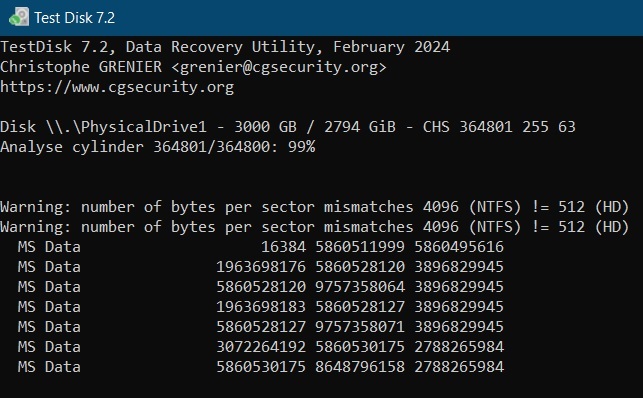

Then a quick search returned "number of bytes per sector mismatches: 4096 (NTFS) ! = 512 (HD)"

Explication 1
The warning labeled
Warning: number of bytes per sector mismatches 4096 (NTFS) != 512 (HD).
that can be seen in your picture, suggests that your disk had been installed in an enclosure that contained an interface that emulated a sector size of 4096 bytes, although the hard disk showed only 512 bytes at its interface.
When the affected partition partition was formated it recorded a sector size of 4096.
The intention of using such interfaces by the manufacturer had been to make big disks (beyond 2GB) usable for people with legacy operating systems such as Windows XP 32 bit which only supports the MBR partition structure. As the MBR partition table contains only 32 bit values to keep sector numbers. Given a sector size of 512 byte the MBR partition table could only address a space of 2^32 * 512 bytes ~= 2 TB.
A disk with a sector size of 4096 bytes, though, (8 times bigger) could address 16 TB instead.
Explication 2
Another explication is that data was stored on a disk with a sector size of 4096 bytes where the size of 4096 byte was recorded in NTFS.
If that disk is cloned onto a disk with a sector size of 512 bytes I would expect similar problems.
