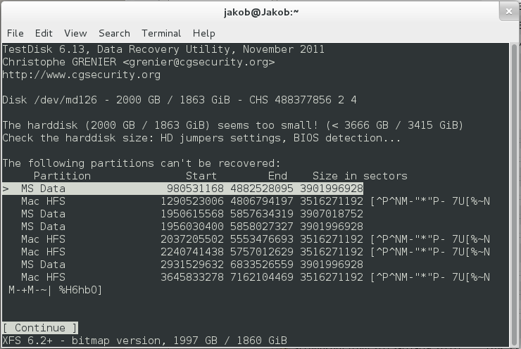

Did a full Deeper Search now (see attachment), doesn't look good i think,...
- 1234.png (64.23 KiB) Viewed 4776 times

What do you mean with desired Partition? Whole block device is one partition^^
TestDisk can find or recognize partitions through remnants or just to recognize any partition.
For example, in your case the MAC HFS-partitoons are probably not needed.
Sometimes during search TestDisk dilplays also the partition label.
In this case you can press F and TestDisk doesn't scan anymore and jumps immediately to the end of the partition.
It's a suggestion to save time!
After Deeper Search, did you check the found MS Data partitions and did you press p to have a try to list your files?
If you found your files on any partition, please let me know, before you recover it!
