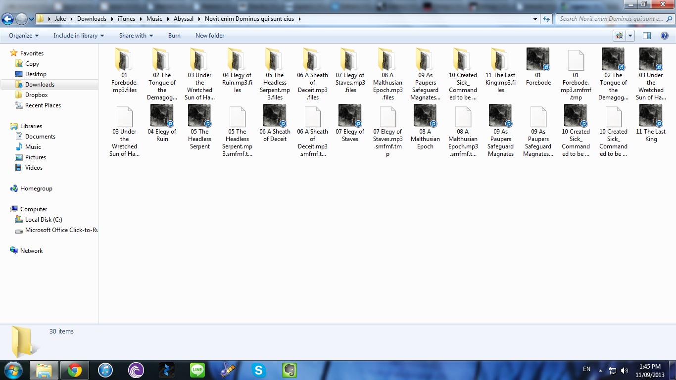

3.a. With the mp3 files, the files in the "doubles" folders look like the cover art from iTunes, and there appear to be some "temp" files as well. Im wondering what will happen when I drag and drop the mp3 folder on the new HDD into my iTunes library - will it copy only the mp3 files into the iTunes library? Will it be like normally adding new files to iTunes folder, whereby I can delete the files from the HDD once iTunes has copied them?

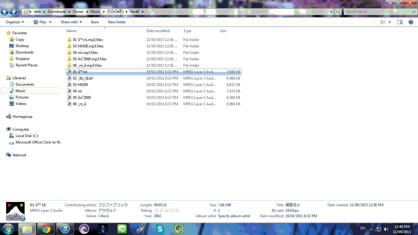

3b.As you can see from the screen 3 picture, some of the file names are scrambled. This is because they were originally in Japanese. I have mp3s like this, with Japanese file names, but after copying them from Testdisk, they also come up scrambled. When I drop the mp3 copies into my iTunes, will it return the filenames in the iTunes destination folder to the Japanese names again (assuming the mp3 sourcecode is still intact)?

Files listed in a red were deleted files. When listing your files, you can choose to hide them and only copy the non-deleted files.snakenuts wrote:3. Regarding the copied files: I tested the copy process and with a couple of photo files and all the MP3 files I got some "doubles" and "temp" files. Although, on TestDisk there were a few folders that didnt have "red" files in them, so I'm assuming that the "doubles" that have been copied onto my PC are "images" of the deleted files from the HDD - is this correct?
No idea, sorrysnakenuts wrote:3b.As you can see from the screen 3 picture, some of the file names are scrambled. This is because they were originally in Japanese. I have mp3s like this, with Japanese file names, but after copying them from Testdisk, they also come up scrambled. When I drop the mp3 copies into my iTunes, will it return the filenames in the iTunes destination folder to the Japanese names again (assuming the mp3 sourcecode is still intact)?

But seriously, thank you so much. I've been learning as I go along. I worked out that if there were no deleted files in one particular folder, then no "doubles" would be copied over onto the new one. But thanks for the suggestion to hide the deleted files.
