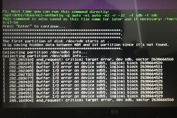

Hi guys,
I tried using Clonezilla. It was easy to use but unfortunately, I have this error. See screenshot below.
Clonezilla1
Clonezilla1
Clonezilla2
Clonezilla2
Any suggestions guys?
Thanks so much again. And sorry to be such a pain. These technical stuff are too alien to me.
THanks again.
Re: WD 2Tb External HDD You need to format the disk Error
Posted: 30 Sep 2012, 05:51
by Lito
I think your actual drives are:
sda (good drive with a working Windows Vista system)
sdb (the drive that holds your precious data, but is damaged)
sdc (the new drive to which you would like to clone sdb)
sd1 and sdb5 are in the same device. They partitions made either by you or somebody else.
The same goes for sdc1, this is a partition that you made. By the way you do not need to have any partition in your good new drive to carry out the cloning. Most restoring tools work best when there is nothing in the drive. To restore Acronis images, for instance, not partition information or formatting is needed, otherwise Acronis trips over.
My suggestion (your free to follow what you feel is best) is:
fetch and burn MiniTool Partition Wizard (free home users bootable CD)
http://www.partitionwizard.com/download.html
Once you have a working CD, wipe your new drive to start afresh. It will take about 4 hours.
When you finish cleaning the drive, you should put the Knoppix CD in the tray.
Make sure all drives are connected as before. Double checking is good.
Then look a my previous post.
There is something missing.
When Knoppix gets to a stop and prompts for
boot:
here foolow the advise given in the relevant page, and type
knoppix lang=us
and then press enter
(please check that this is correct).
As for the rest of the commands I did try then, working from the same Knoppix CD (Version 7.0.4 english version), with disks attached to my machine. The only difference is that the disk i was cloning was not damaged and it was smaller.
Best of luck.
