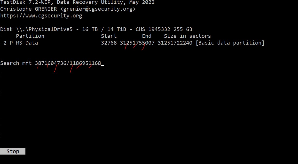

It continues.. Is it supposed to do this? Maybe I messed up on the numbers. Maybe the screenshot syndrome has kicked in?
Nope, I added commas. Maybe it is counting to the size in sectors #?
Log file is unchanged.
I eliminated the system problems.
Please advise.,
thanks!

As far as I can trace that you are seeing a display issue. The internal working of Testdisk is OK. At the moment you should ignore both figures behind "Search mft".
Re: testdisk Weird output with 18TB drives, recovery question
I have uploaded a new 7.2-WIP version. Do you still have the output problem ?

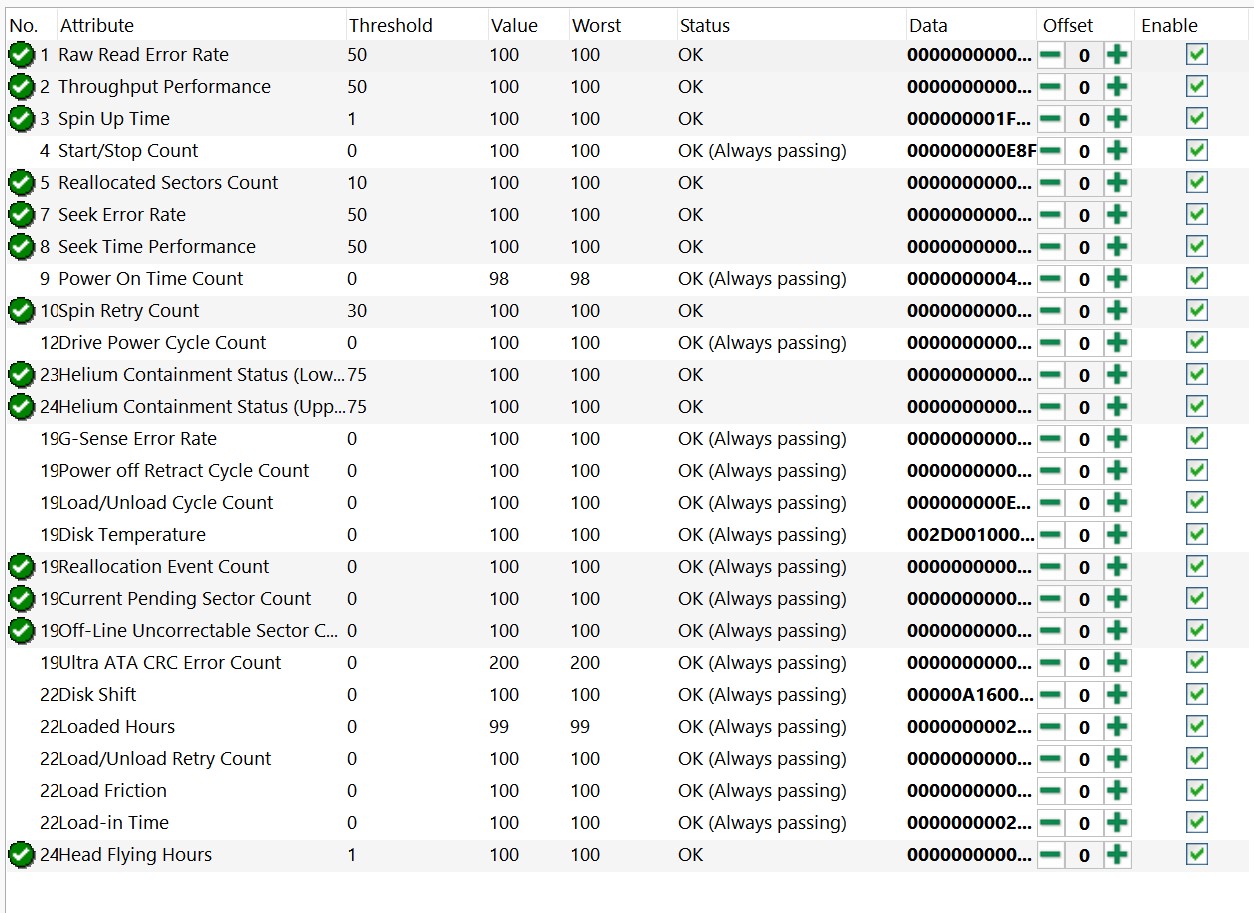

It is a Toshiba drive, they only have one outdated tool. It doesn't even recognize the drive. Seatools (Seagate's tool that has done an excellent job in the last with all makes/models of drives for me) SMART tests fine, short drive self-test shows ok. Generic short test passes, long generic test states it will take 28:53 to complete, but gets stuck at 0%.
I have been running Hard Disk Sentinel pro for about a year, it was helpful with a potentially failing drive in the past. The smart values are attached from HDS. Nothing looks wrong, but Ontrack Easyrecovery states there are bad sectors, and since it is SATA now I believe it.
