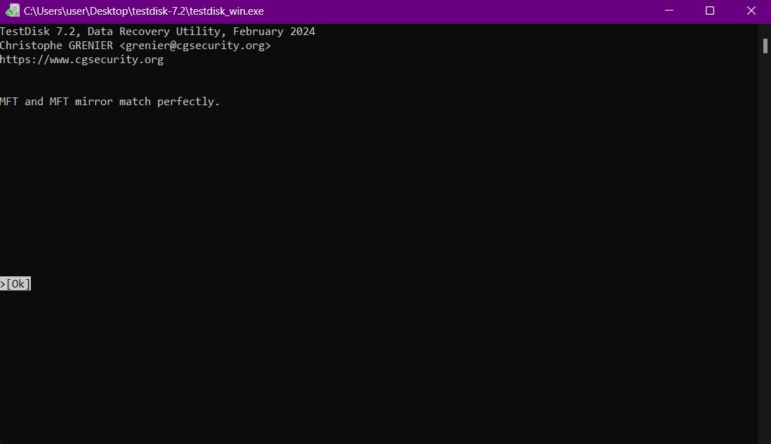

Hello Recuperation,
I choose the "Repair MFT" option, and it shows the screen as below
It seems I have no further command to repair it?
Thank you.
Re: Raw drive not bootable ?
Posted: 19 May 2024, 08:56
by recuperation
Yes.
Posted: 19 May 2024, 12:02
by Azuma
Hi Recuperation,
It's strange that the Boot Sector checking with Testdisk showing OK (for the backup as well), and the Repair MFT option shows no further choice.
But this hard drive with one partition only, and it becomes Raw now and seems it is dead forever.
Is there anyway to fix it with other Testdisk function or chkdsk?
Thank you
Posted: 19 May 2024, 13:03
by recuperation
Azuma wrote: 19 May 2024, 12:02 Hi Recuperation,
It's strange
No, it's not. But I won't go into details.
The content of your disk is unreadable. This does not mean that the disk is dead. If there is no physical dammage you can erase everything, partition the disk and format one or more partitions.
Maybe. Go to a recovery lab have somebody manually work on it for a four digit USD price. Or learn file system internals and do it yourself.
Have you read my answer above?
or chkdsk?
Here is the right person to help you out for foreseeing the outcome of using chkdsk. The lady is less expensive than a recovery lab (only three digit price in USD). Clone your disk before using chkdsk - its operation cannot be reverted and it may destroy evidence other software could have analysed.
