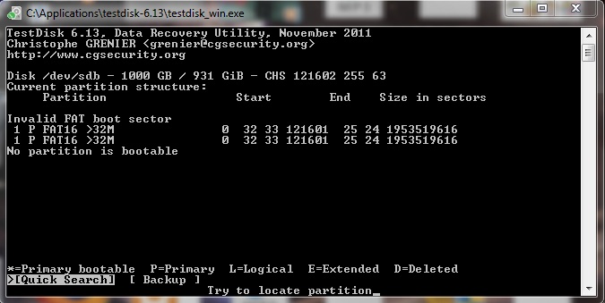

I went ahead with the instructions.
Change partition type:
1 P FAT16 >32M 0 32 33 121601 25 24 1953519616
1 P HPFS - NTFS 0 32 33 121601 25 24 1953519616
ntfs_boot_sector
filesystem size 1
sectors_per_cluster 0
mft_lcn 0
mftmirr_lcn 0
clusters_per_mft_record 0
clusters_per_index_record 0
Status: Bad
Status: Bad
Sectors are identical.
rebuild_NTFS_BS
file_pread(5,16,buffer,1927445824(119977/243/11)) read err: Invalid argument
ntfs_boot_sector
filesystem size 1
mft_lcn 0
mftmirr_lcn 0
Status: Bad
Status: Bad
Repairing an NTFS

Re: Repairing an NTFS
i posted the log of the diagnosis above, from the RebuildFS, as it didnt work

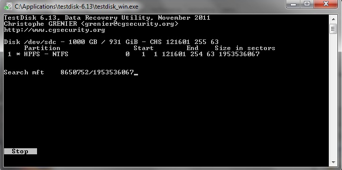

I had to go through the whole thing on RebuildFS, so it took 4 hours, and it still had the same result.
This time I attached the log because it was longer
http://www.mediafire.com/?x7403dwge47qlx8
- screen2.jpg (57.72 KiB) Viewed 51622 times
- screen1.jpg (41.31 KiB) Viewed 51622 times

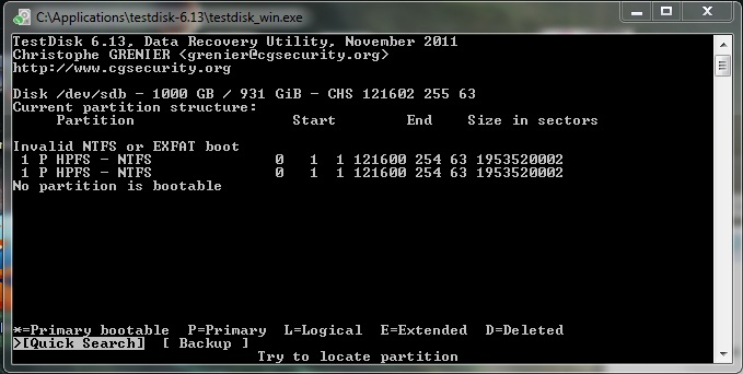

Sry I've seen something wrong.
I've used your screen from here, if you watch your disk;
http://forum.cgsecurity.org/phpBB3/down ... php?id=144
The amount of cylinders is 121602 but it's 121601.
See your last screen.
So it might be necessary to add your partition again using the following values;
[ Cylinders ] [ Heads ] [ Sectors ] [ Cylinders ] [ Heads ] [ Sectors ] [ Type ] [ Done ]
......0....... .....1..........1..........121600.......254........63.........07.....[Enter]
The value is 121600 now!
Sry for the inconvenience!

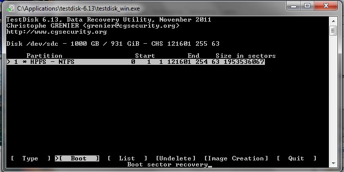

Ok, then here is the latest log/screenshots
Fri Mar 16 07:05:16 2012
OS: Windows 7 (7600)
disk_get_size_win32 IOCTL_DISK_GET_LENGTH_INFO(/dev/sdc)=250059350016
disk_get_size_win32 IOCTL_DISK_GET_LENGTH_INFO(\\.\PhysicalDrive2)=250059350016
disk_get_size_win32 IOCTL_DISK_GET_LENGTH_INFO(\\.\C:)=250057064448
disk_get_size_win32 IOCTL_DISK_GET_LENGTH_INFO(\\.\D:)=159934054400
disk_get_size_win32 IOCTL_DISK_GET_LENGTH_INFO(\\.\E:)=8066271232
disk_get_size_win32 IOCTL_DISK_GET_LENGTH_INFO(\\.\G:)=1000210466304
file_pread(4,1,buffer,312581919(73444/223/19)) lseek err Invalid argument
file_pread(5,1,buffer,1953536129(121601/254/63)) lseek err Invalid argument
file_pread(6,1,buffer,488408129(30401/254/63)) lseek err Invalid argument
Disk /dev/sda - 160 GB / 149 GiB - CHS 73444 224 19, sector size=512 - WDC WD1600JB-00EVA0, S/N:4457572d414d4b45303332343534 034 0 0 0 0, FW:15.05R15
Disk /dev/sdb - 1000 GB / 931 GiB - CHS 121601 255 63, sector size=512 - WDC WD10EADS-11M2B2, S/N:2020202057202d44435756414335313134383337, FW:80.00A80
Disk /dev/sdc - 250 GB / 232 GiB - CHS 30401 255 63, sector size=512 - WDC WD2500KS-00MJB0, S/N:2020202057202d4443574e41334b313539353935, FW:02.01C03
Drive E: - 8066 MB / 7692 MiB - CHS 1923 64 32, sector size=2048 - ASUS DRW-1608P3S, FW:1.06
Disk /dev/sdb - 1000 GB / 931 GiB - WDC WD10EADS-11M2B2
1 * HPFS - NTFS 0 1 1 121601 254 63 1953536067
Not an exFAT boot sector.
Invalid NTFS or EXFAT boot
Backup partition structure
partition_save
Ask the user for vista mode
Computes LBA from CHS for Disk /dev/sdb - 1000 GB / 931 GiB - CHS 121602 255 63
search_vista_part: 1
HPFS - NTFS 0 1 1 121600 254 63 1953520002
1 P HPFS - NTFS 0 1 1 121600 254 63 1953520002
write!
Analyse Disk /dev/sdb - 1000 GB / 931 GiB - CHS 121602 255 63
write!
ntfs_boot_sector
filesystem size 1
mft_lcn 0
mftmirr_lcn 0
Status: Bad
Status: Bad
rebuild_NTFS_BS
file_pread(5,16,buffer,1927445823(119977/243/10)) read err: Invalid request code
file_pread(5,16,buffer,1927446976(119978/6/29)) read err: Invalid request code
ntfs_boot_sector
filesystem size 1
mft_lcn 0
mftmirr_lcn 0
Status: Bad
Status: Bad
