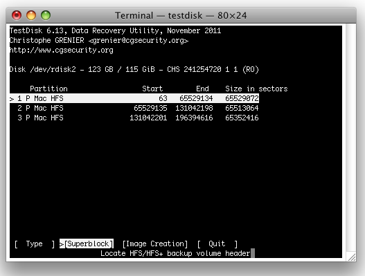

But if you found your partition and it's in your GUID partition table, then it would be possible to try Advanced, your partition must be chosen and Superblock if avialable.
Would it be possible to upload a screenshot from the menu Advanced and if possible Superblock also.

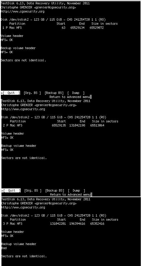

Below are the screenshots from the Advanced menu:
Partitions 1&2 recovered OK.  Partition 3 Failed
Partitions 1&2 recovered OK. But partition 3 Failed
Testdisk originally listed sector length of partition 3 inaccurately/too long(65513064). I changed this because partition is 31.16 GB which 65352416 matches.
I had also tried to recover with sector length 65513064 but that failed also.

HFS_HFSP_boot_sector
1 P Mac HFS 63 65529134 65529072
HFS+, 33 GB / 31 GiB
HFS+ magic value at 63/0/1
Volume header
HFS+ OK
Backup volume header
HFS+ OK
Sectors are not identical.
2 P Mac HFS 65529135 131042198 65513064
HFS+ magic value at 65529135/0/1
Volume header
HFS+ OK
HFS+ OK
3 P Mac HFS 131042201 196394616 65352416
HFS+ magic value at 131042201/0/1
Volume header
HFS+ OK
Bad
