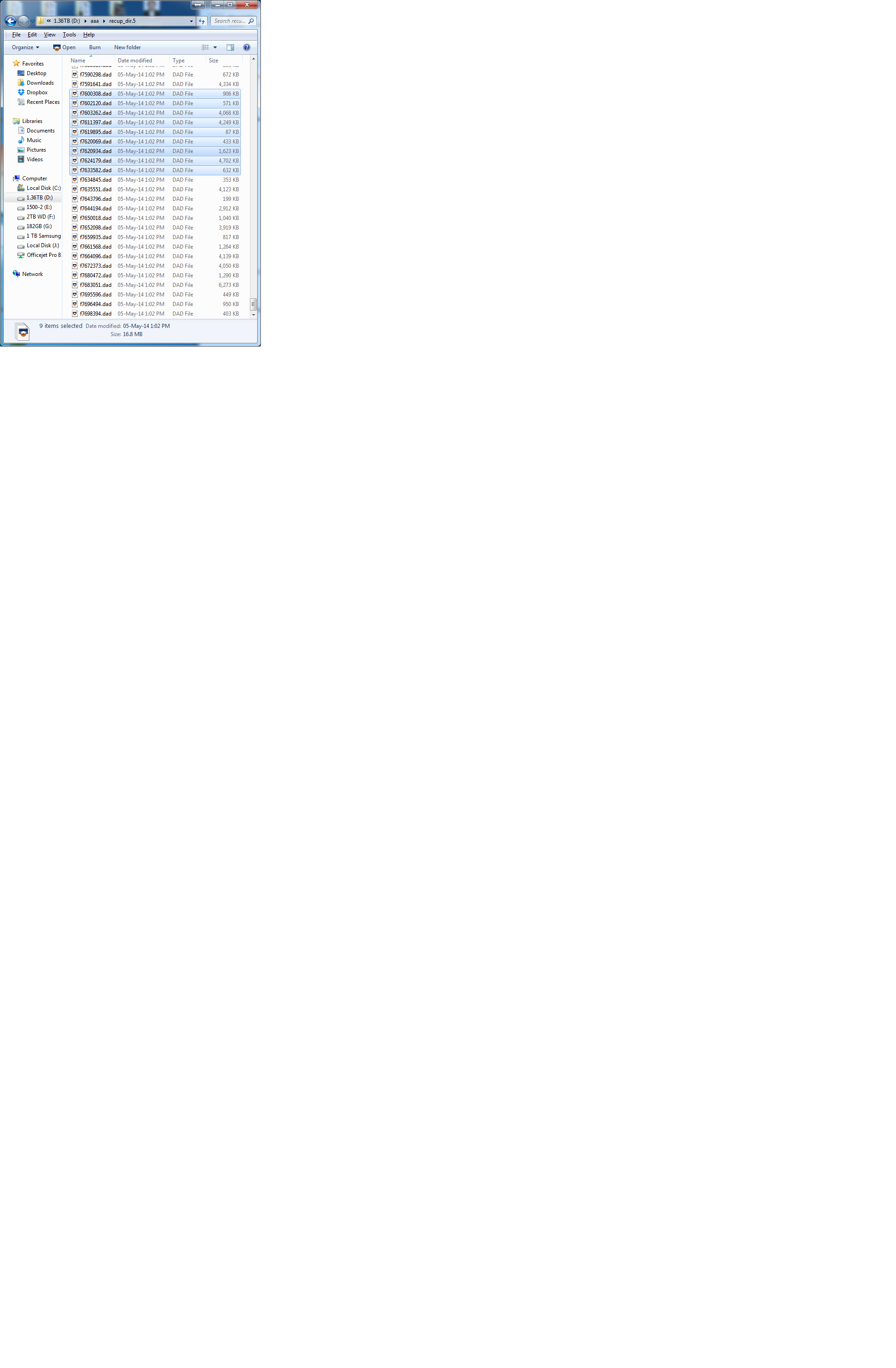

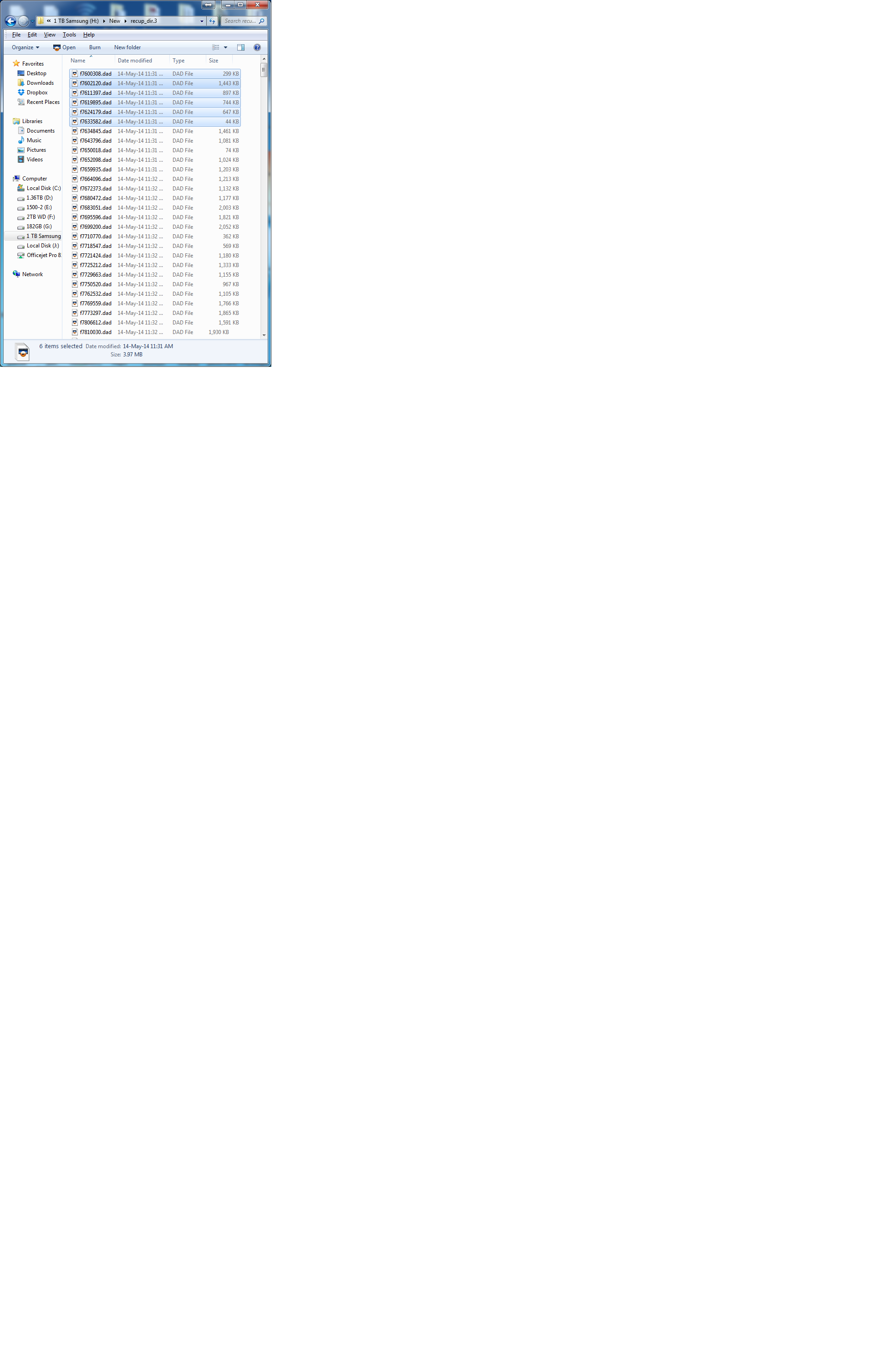

unfortunately it is again thousands of small files
but the dad files starting at the same sector are with different size now
for example f7611397.dad was 4249kb in the previous recovery, the same file is 897 kb now
when I open them I think this time all files contain only 1 cam, so I think you solved the cam merge
but now the remaining part of the files are gone
An example of the files from a certain sector to another sector are as attached.
From 7600308 to 7633582
Old recovery recovers 9 files of 16.8Mb
New recovery recovers 6 files of 3.97Mb
Also the recupdir directories are different as you can see above
- oldrec.png (182.56 KiB) Viewed 10178 times
- newrec.png (192.48 KiB) Viewed 10178 times
