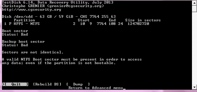

Where do I find the menu list? I'm sure the files still exist inside as I could get some of them off from another recovery software.
- microsd4.jpg (79.19 KiB) Viewed 12826 times

Looks like running RebuildBS wasn't successful?
If both sectors, your boot sector and its backup are bad, you'll not find the menu list.
Now it's coming up the next test to check.
TestDisk found during Quick Search a partition which doesn't start at the beginning of your card and ends after the limit.
Confirm in testdisk through, until you see Analyse
Check the menu Geometry and mark cylinder and press enter.
Change the value to 7845 and leave the menu at Ok.
Run Analyse and Quick Search.
If a partition is listed, you can press enter to stop the scan.
Your unrecoverable partition should be listed.
Please press p to have a try to list your data.
If you get a message like filesystem is damaged, please let me know.
All these steps are only intended for diagnosing purposes, your're not going to change anything to your card.
That's why it's not recommended to use the menu write.
