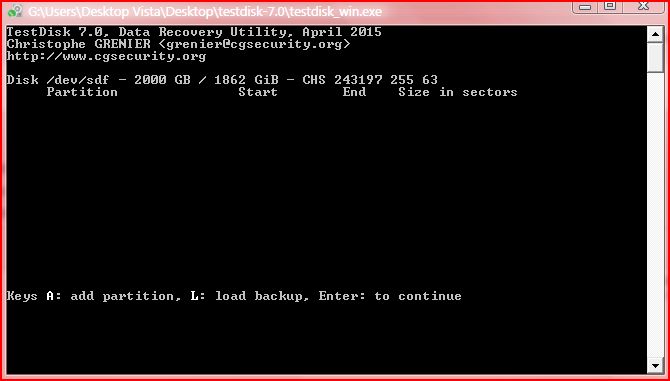

I was wondering if changing Disk geometry might help. I don't know how to fill in the information.
I was wondering if writing the Testdisk MBR code to first sector would help?
Should I add a partition once a scan is complete?
How do I upload large log files?
Thank you.
Blank external Hard-drive. Windows says must format it.

- Testdisk-AddPartition.JPG (38.34 KiB) Viewed 7050 times
Re: Blank external Hard-drive. Windows says must format it.
There are a lot of read errors. As the testdisk.log file records all the problem, it is very large due to the bad disk.

+ Device Identification [4 bytes]:
* Vendor [32 bytes]: WD
* Product [64 bytes]: My Book 1130
* Firmware [16 bytes]: 1012
* Serial Number [32 bytes]: WCAZA4151824
* Bus Type [4 bytes]: USB
* Int13 Drive Number [4 bytes]: 0x85
- Drive Number 42 --------------------------------
* Drive Type [256 bytes]: Physical Drive,Disk
* Name [42 bytes]: WD My Book 1130 1012
* OS Object [40 bytes]: \\.\PhysicalDrive11
* R-Studio Driver [44 bytes]: WinNT\Handle\Physical
* Sector Size [4 bytes]: 512B
* Partition Size [8 bytes]: 1.81TB (-388003840 sec)
# I/O Tries [4 bytes]: Default
+ Drive Control [4 bytes]:
# Maximum Transfer [4 bytes]: 131072
# I/O Unit [4 bytes]: 512
# Buffer Alignment [4 bytes]: 4
+ Physical Drive Geometry [4 bytes]:
* Cylinders [8 bytes]: 243197
* Tracks Per Cylinder [4 bytes]: 255
* Sectors Per Track [4 bytes]: 63
- Drive Number 43 --------------------------------
* Drive Type [256 bytes]: Volume,Disk
* Name [6 bytes]: O:
* Mount Points [8 bytes]: O:\
* OS Object [98 bytes]: \\?\Volume{ebc91797-a2c5-11e6-94c2-a78cf8021da5}
* R-Studio Driver [42 bytes]: WinNT\Handle\Logical
* Size [8 bytes]: 1.81TB (-388005888 sec)
* Partition Offset [8 bytes]: 1.00MB (2048 sec)
* Partition Size [8 bytes]: 1.81TB (-388005888 sec)
* Partition Number [4 bytes]: 1
* Partition Type [256 bytes]: NTFS/HPFS/exFAT (0x7)
* Cylinders [8 bytes]: 0
* Tracks Per Cylinder [4 bytes]: 0
* Sectors Per Track [4 bytes]: 0
* Sector Size [4 bytes]: 0B
Severity Type Date Time Message
Error System 01/12/2016 10:00:43 AM Read disk O: at position 15131444224 failed after 1 attempts. The system cannot find the file specified (2)
Error System 01/12/2016 10:00:43 AM Read disk O: at position 15131444736 failed after 1 attempts. The system cannot find the file specified (2)
Error System 01/12/2016 10:00:43 AM Read disk O: at position 15131445248 failed after 1 attempts. The system cannot find the file specified (2)
Error System 01/12/2016 10:00:43 AM Read disk O: at position 15131445760 failed after 1 attempts. The system cannot find the file specified (2)
Error System 01/12/2016 10:00:43 AM Read disk O: at position 15131446272 failed after 1 attempts. The system cannot find the file specified (2)
The Errors continued and I stopped the scan. Similar things happened with the testdisk logs.
Mon Nov 21 11:58:16 2016
OS: Windows Vista (6002) SP2
disk_get_size_win32 IOCTL_DISK_GET_LENGTH_INFO(/dev/sdd)=1500301910016
disk_get_size_win32 IOCTL_DISK_GET_LENGTH_INFO(/dev/sde)=8002732032
disk_get_size_win32 IOCTL_DISK_GET_LENGTH_INFO(/dev/sdj)=2000365289472
disk_get_size_win32 IOCTL_DISK_GET_LENGTH_INFO(/dev/sdk)=2000398934016
disk_get_size_win32 IOCTL_DISK_GET_LENGTH_INFO(\\.\PhysicalDrive3)=1500301910016
disk_get_size_win32 IOCTL_DISK_GET_LENGTH_INFO(\\.\PhysicalDrive4)=8002732032
filewin32_getfilesize(\\.\PhysicalDrive7) GetFileSize err Incorrect function.
filewin32_setfilepointer(\\.\PhysicalDrive7) SetFilePointer err Incorrect function.
filewin32_getfilesize(\\.\PhysicalDrive8) GetFileSize err Incorrect function.
filewin32_setfilepointer(\\.\PhysicalDrive8) SetFilePointer err Incorrect function.
Warning: can't get size for \\.\PhysicalDrive8
disk_get_size_win32 IOCTL_DISK_GET_LENGTH_INFO(\\.\PhysicalDrive9)=2000365289472
disk_get_size_win32 IOCTL_DISK_GET_LENGTH_INFO(\\.\PhysicalDrive10)=2000398934016
disk_get_size_win32 IOCTL_DISK_GET_LENGTH_INFO(\\.\C:)=408021893120
disk_get_size_win32 IOCTL_DISK_GET_LENGTH_INFO(\\.\D:)=2000396746752
disk_get_size_win32 IOCTL_DISK_GET_LENGTH_INFO(\\.\E:)=2000396746752
disk_get_size_win32 IOCTL_DISK_GET_LENGTH_INFO(\\.\F:)=1500299395072
disk_get_size_win32 IOCTL_DISK_GET_LENGTH_INFO(\\.\G:)=592179101696
disk_get_size_win32 IOCTL_DISK_GET_LENGTH_INFO(\\.\H:)=8002715136
filewin32_getfilesize(\\.\I:) GetFileSize err Incorrect function.
filewin32_setfilepointer(\\.\I:) SetFilePointer err Incorrect function.
filewin32_getfilesize(\\.\J:) GetFileSize err Incorrect function.
filewin32_setfilepointer(\\.\J:) SetFilePointer err Incorrect function.
disk_get_size_win32 IOCTL_DISK_GET_LENGTH_INFO(\\.\K:)=0
Warning: can't get size for \\.\K:
disk_get_size_win32 IOCTL_DISK_GET_LENGTH_INFO(\\.\M:)=0
Warning: can't get size for \\.\M:
disk_get_size_win32 IOCTL_DISK_GET_LENGTH_INFO(\\.\O:)=2000364240896
Disk /dev/sdb - 2000 GB / 1863 GiB - CHS 243201 255 63, sector size=512
Disk /dev/sdc - 2000 GB / 1863 GiB - CHS 243201 255 63, sector size=512
Disk /dev/sdd - 1500 GB / 1397 GiB - CHS 182401 255 63, sector size=512
Disk /dev/sde - 8002 MB / 7632 MiB - CHS 972 255 63, sector size=512
Disk /dev/sdj - 2000 GB / 1862 GiB - CHS 243197 255 63, sector size=512
Disk /dev/sdk - 2000 GB / 1863 GiB - CHS 243201 255 63, sector size=512
Drive C: - 408 GB / 380 GiB - CHS 49605 255 63, sector size=512
Drive D: - 2000 GB / 1863 GiB - CHS 243201 255 63, sector size=512
Drive F: - 1500 GB / 1397 GiB - CHS 182401 255 63, sector size=512
Drive G: - 592 GB / 551 GiB - CHS 71995 255 63, sector size=512
Drive H: - 8002 MB / 7631 MiB - CHS 972 255 63, sector size=512
Drive O: - 2000 GB / 1862 GiB - CHS 243197 255 63, sector size=512
Analyse Disk /dev/sdj - 2000 GB / 1862 GiB - CHS 243197 255 63
Partition: Read error
file_pread(9,16,buffer,32(0/0/33)) ReadFile The specified network resource or device is no longer available.
file_pread(9,3,buffer,48(0/0/49)) ReadFile The specified network resource or device is no longer available.
file_pread(9,3,buffer,95(0/1/33)) ReadFile The specified network resource or device is no longer available.
file_pread(9,8,buffer,111(0/1/49)) ReadFile The specified network resource or device is no longer available.
The errors just continue with the large log file testdisk made.
The disk is in a bad shape, there is a hardware problem. You need to contact a data recovery company.
SyncroScales
- Posts: 20
- Joined: 09 Nov 2016, 23:10
So Write Testdisk MBR code to first sector won't work?
When does someone use Write Testdisk MBR code to first sector won't work?
The thing is that Windows Vista recognizes the external hard-drive in Device Manager and wants to Format it. Safely Remove also recognizes the external hard-drive. So I think it is there. But I am skeptical to re-format the external hard-drive in-case I lose 25%-35% of the data?
I plan to speak to a Western Digital representative who emailed me about the drive also.
