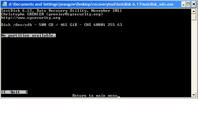

Hi Fiona,
I could not rebuild boot sector by following steps:
Start TestDisk
Confirm through until i see the menu Analyse.
Confirm at Advanced
As 'no partition is available', it shows 'quit' only. I can't carry on Running a revbuild BS.
What else can we do to recover Boot sector / partition?

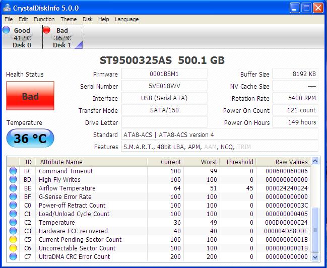

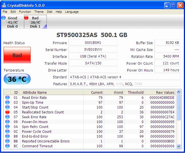

From Crystal Disk Info, i upload two screen shots as following:

It's advisable to stress your disk as little as possible.
Should be probably later replaced.
But as long as it gets recognized you can try to get your data off of your harddrive.
Your boot sector diagnose didn't work, because there is no partition in your partition tbale.
That's why TestDisk doesn't list it using "Advanced".
To avoid any further damage, would you like to clone your disk or to diagnose it in the current status?
Please let me know.
How many partitions did you have on your disk?
Might be also possible to create one and having a boot sector diagnose.
Creating a partition would be only in your MBR and your MBR size is 512 Byte.

That disk is broken and will probably continue to get worse as you try things with it.
The best chance you have at getting all of your data (or at least as much as is physically possible) at this point is to make an exact image of it and then run your repair/recovery on the image and set the actual drive aside in case the image is damaged by the recovery attempts. That way you may be able to make another image if needed.
To be extra cautious, you could make a copy of the image before attempting recovery and always be able to try repeatedly with copies of the image and never have to access the actual disk again.
