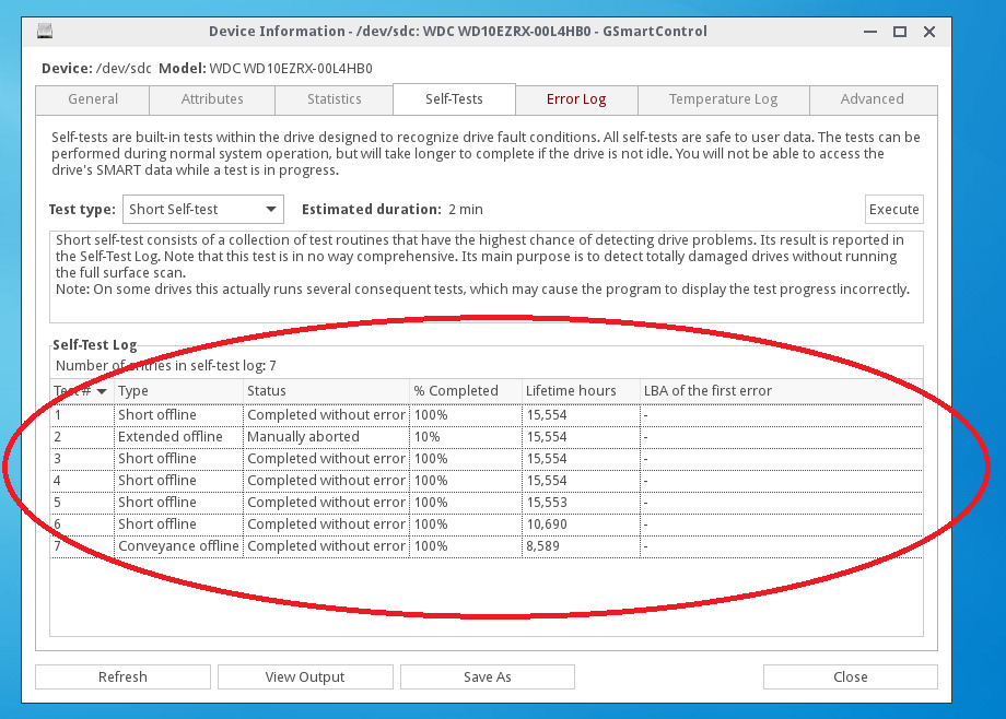

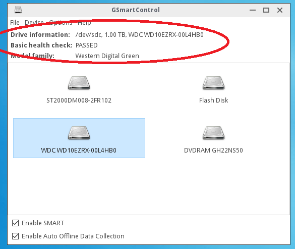

Re: Data Recovery Issues on a 1TB Drive
Hi recuperation,
Sorry I didn't post back sooner I had an emergency this weekend.
I'm referring to the GSmartControl Basic Tests, both Short and Extended.
Both Tests say "PASSED" and " Completed Without Error, 100%". (Posted Picture)
After working with you this past week I'm understanding what I'm looking at a little more and the drive is definitely throwing Errors.
I missed it before because the tests keep saying "Passed" and I just don't know enough.
I really don't get it; the drive says "PASSED" every time but throws errors and still wont connect.
Below is the GSmart Log from the last "Extended Test".
I am also attaching screenshots I took of the last round of tests, so you can see what I'm talking about.
Edit: Having trouble with the picture size., will try again later.
As Always, Thanks for everything!!

SMART Extended Self-test Log Version: 1 (1 sectors)
Num Test_Description Status Remaining LifeTime(hours) LBA_of_first_error
# 1 Short offline Completed without error 00% 15554 -
# 2 Extended offline Aborted by host 90% 15554 -
# 3 Short offline Completed without error 00% 15554 -
# 4 Short offline Completed without error 00% 15554 -
# 5 Short offline Completed without error 00% 15553 -
# 6 Short offline Completed without error 00% 10690 -
# 7 Conveyance offline Completed without error 00% 8589 -
1 0 0 Not_testing

Error 57573 [20] occurred at disk power-on lifetime: 15557 hours (648 days + 5 hours)
ER -- ST COUNT LBA_48 LH LM LL DV DC
04 -- 51 00 02 00 00 00 00 00 00 a0 00 Error: ABRT
CR FEATR COUNT LBA_48 LH LM LL DV DC Powered_Up_Time Command/Feature_Name
ef 00 10 00 02 00 00 00 00 00 00 a0 00 00:00:02.884 SET FEATURES [Enable SATA feature]
ec 00 00 00 00 00 00 00 00 00 00 a0 00 00:00:02.883 IDENTIFY DEVICE
c8 00 00 00 08 00 00 00 00 00 00 e0 00 00:00:02.861 READ DMA
ef 00 10 00 02 00 00 00 00 00 00 a0 00 00:00:02.860 SET FEATURES [Enable SATA feature]
ec 00 00 00 00 00 00 00 00 00 00 a0 00 00:00:02.860 IDENTIFY DEVICE
Error 57572 [19] occurred at disk power-on lifetime: 15557 hours (648 days + 5 hours)
04 -- 51 00 08 00 00 00 00 00 00 e0 00 Error: ABRT 8 sectors at LBA = 0x00000000 = 0
ef 00 03 00 46 00 00 00 00 00 00 a0 00 00:00:02.860 SET FEATURES [Set transfer mode]
1 0 0 Not_testing
2 0 0 Not_testing
Hi recuperation,
I was able to crop the pictures down so they fit...
GSmart Test Images:
GSmart Test Images:

Recuperation,
Yesterday I ran a TESTDISK "Analyze" and got a "Partition: Read error" again.
I then ran the "Quick Search", it ran for 6hrs or so and only got to 3%, it again errored on every cylinder.
I stopped the "Quick Search" because the ATA Error Count jumped from 3,000 to 59,000 and I was concerned about the platter.
Im convinced the data is still there and didnt want to cause further problems.
The drive seems to be spinning up correctly, I had my ear to it for a few min and still shows no signs of physical damage.
I will upload the pictures after this post.
Also I have attempted to connect the drive to a different machine running Windows7, through my USB SATA interface and got the same I/O error.
I currently have the drive connected directly to the motherboard and getting the same results in Windows10 and Parted Magic as before.
I am going to attempt to switch the control board on the drive at some point over the next few days and will let you know how that goes.
