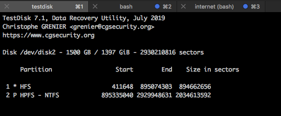

Hi. Sorry, I didn't write clearly what I wanted to ask.
I have this result if I perform a search using Intel as partition map:
Screen Shot 2019-12-28 at 5.29.54 PM.png (36.13 KiB) Viewed 1972 times

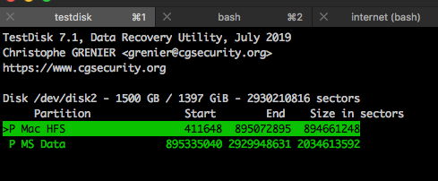

And I have this result if I perform a search using EFI (status quo):
Screen Shot 2019-12-28 at 5.40.07 PM.png (32.48 KiB) Viewed 1972 times
Since they have different ends/sizes, do you think I could try writing the Intel results to see if I can get the Mac partition mounted? Or would this change be potentialy destructive?

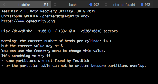

I also get this message before trying the search using Intel partition map:
Screen Shot 2019-12-28 at 5.28.47 PM.png (45.81 KiB) Viewed 1972 times
Again, is this something I could try or is it dangerous?

robertosc wrote: 28 Dec 2019, 06:05 Hi. Sorry, I didn't write clearly what I wanted to ask.

As the partitions don't overlap and even have space for the required partition map sector in between I don't see a risk.
Write down the differing end sector number nevertheless.
The intel style partition map does not look like the usual tables with cylinder, head and sector information. I assume there is no intel style partition map until now.
The standard answer to your question is rather: Duplicate the drive!
You could try to partition another drive with a maximum capacity of 2TB to see what kind of map your computer is writing assuming that you did the partitioning of your drive yourself sometimes in the past.
