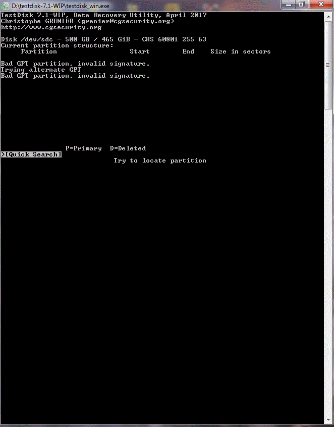

Hello.
I've tried to use testdisk to fix my external HD problem (the file type turned to RAW).
But after the ANALYZE step, the result is as picture below:-
Then, the system just continue to stuck at this stage.
Please help me.
Thank you in advance.
Re: Problem recovering partition/filesystem
#25 Post by cgrenier »
The disk may be using a PC Intel partition table instead.
Please copy and paste the testdisk.log file content.
