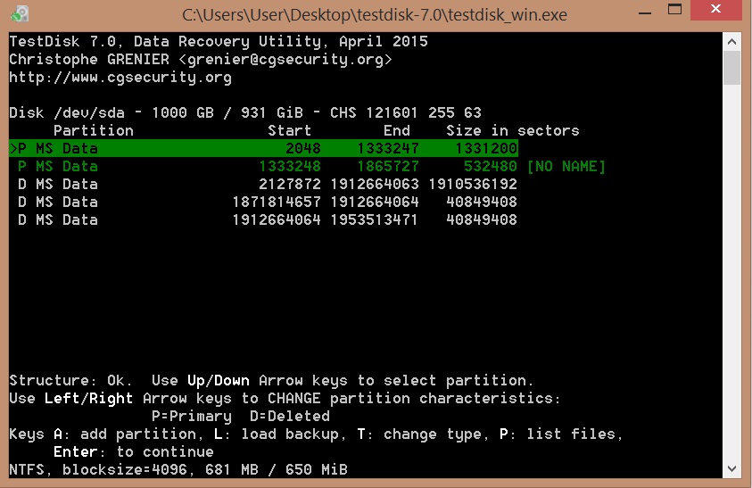

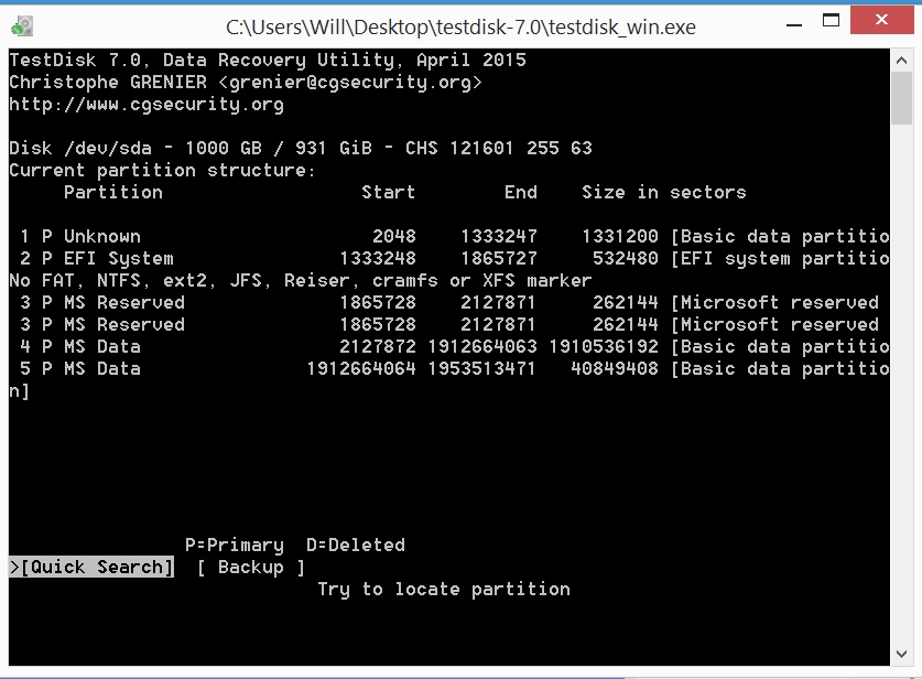

Just an update.
The shop somehow managed to fix my laptop, and managed to factory reset it, which is great.
However, I've spotted a few things which is odd which may be caused by me trying to fix the issue using TestDisk.
For example, when I go into "My Computer", I now see an extra drive, which I didn't see before when I bought this laptop: I think it should be invisible?
What's even odd is that when I go into Disk Management, I see duplication of partitions: I now see the Recovery Drive D: twice!
I'm guessing this is because when I followed your / cgrenier's instructions to write the partition table, it must have written duplicated partitions to the partition table?
Also, I'm guessing if I do a factory reset, I will still see this extra drive? Since a factory reset may only restore the C: drive? If so, how can I get it back to how it was when I bought the laptop? Could you tell what it might have been from looking at my first screenshots from my original post? Ie. reverse engineer it?
If I have to use TestDIsk to write partition table again, I'm happy to do it. Please let me know.
Thank you!
Thank you!

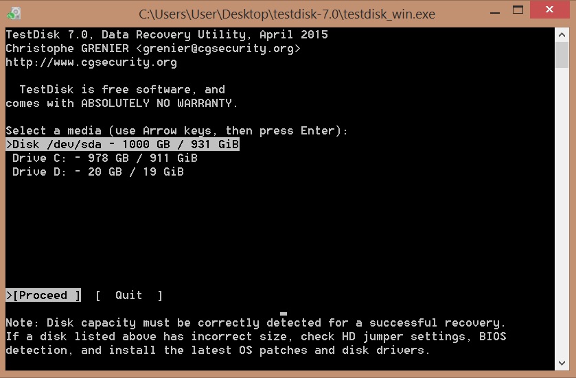

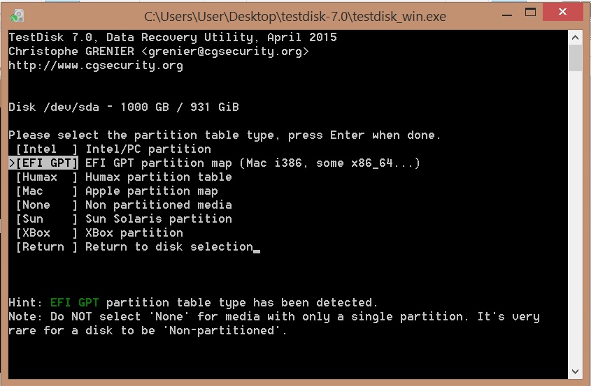

Re: Help needed with TestDisk
I've just downloaded TestDisk onto my HP laptop (no need to use USB docking station anymore), and I can see 3 "media" when I first load it up:
The first one's partition table type is "EFI GPT", but the 2nd and 3rd one are "None".
Here are the next 2 screenshots when I select the first "media":
Hi Fiona,
Thanks for your PM, you can see from my previous post, that I've already uploaded snapshot of what I see when I first run TestDisk.
In testdisk32.jpg, I see 3 media.
When I select the first media called "Disk /Dev/sda - 1000GB /931 GiB", I then see this testdisk33.jpg.
If I click "Analyse", I see this: If I click "Quick Search", I see this:
