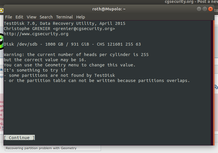

So, after Deeper search TestDisk recomended to Use Geometry but I really dont' know how to proceed.

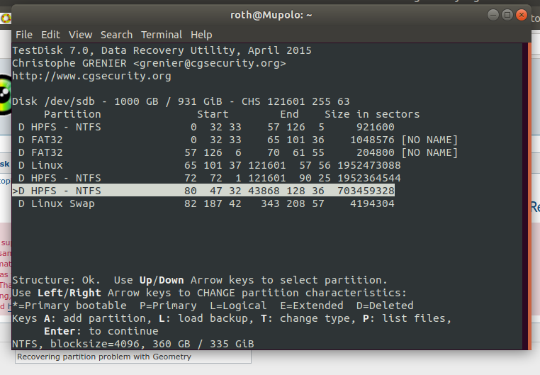

This is the partition I need to recover:

Why are you forcing the partition table type to PC Intel ? Unless you are using a system older than 10 year, EFI GPT is the recommended choice.
You can ignore the message about the Geometry.
After Deeper Search, use the arrow keys to switch the partition to keep/recover from D(eleted) to P(rimary) or *(bootable).

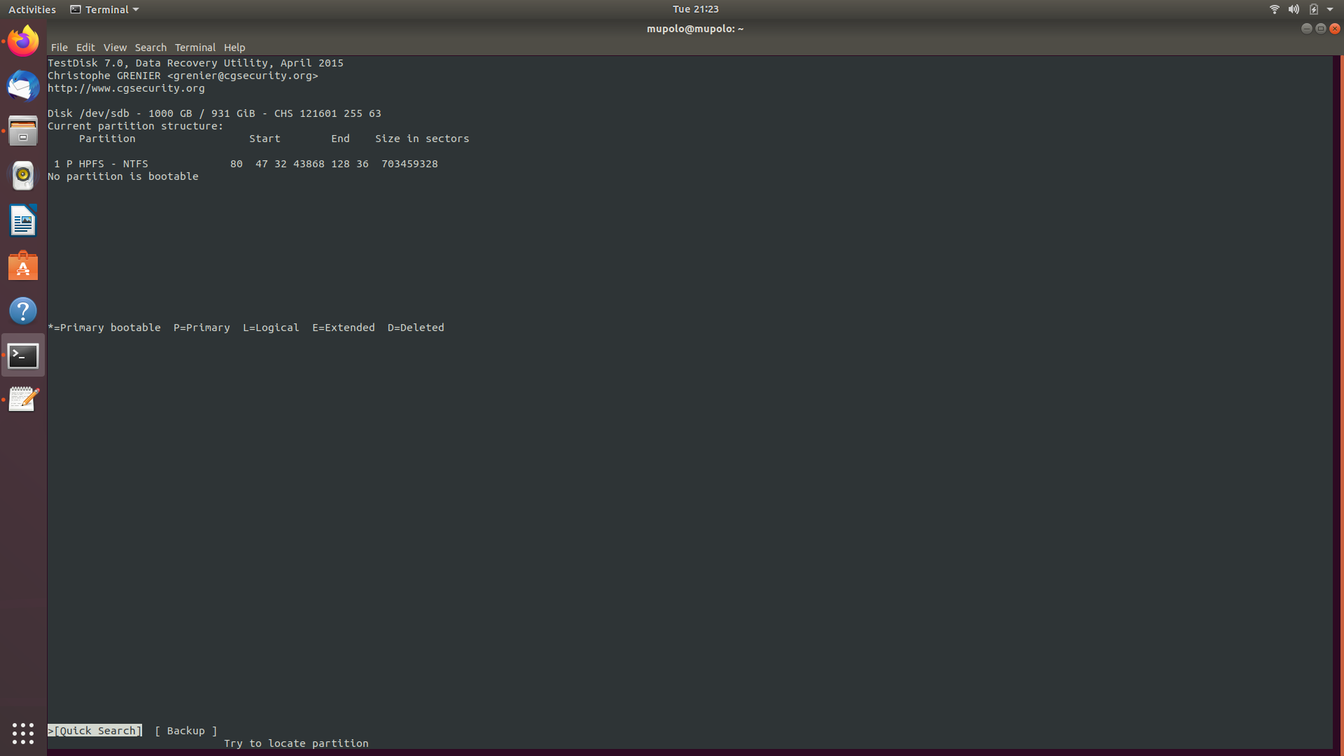

I tried analysing with EFI as you suggested but TestDisk wouldn't find my partition, so I stopped the search and tried PC intel again. There, after deeper search I found it. I changed the D to Primary y went ahead to write. Reebooted but I don't know if I shold mount the image to find my files or do I have to do something else. I really don't want to screw this up. I'll wait for your suggestions.

Apparently Testdisk successfully wrote my missing partition. There were other partitions on that scheme but I don't need those So I chose to write Only the one selected in this image:

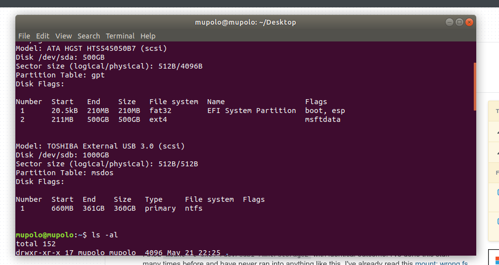

I looked for the device to try and mount it. It was there:
But I couldn't mount it. when I tried sudo mount I got this:
wrong fs type, bad option, bad superblock on /dev/sdb, missing codepage, or helper program, or other error

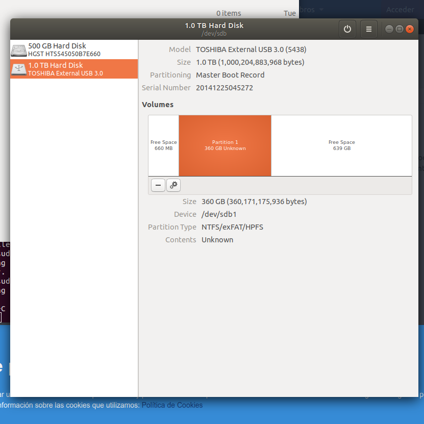

If I use Disks It shows me this:
How can I mount the HDD so I can gain access to my files?
